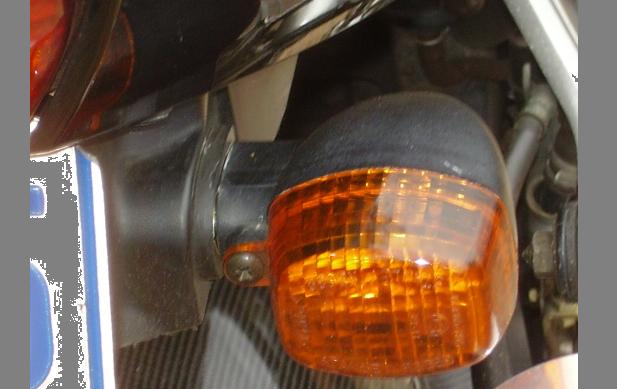

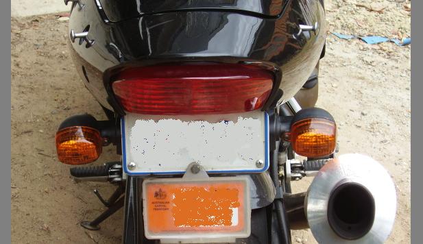

Did this mod ages ago, and promised Blue12 I would post it up sometime..... :oops:
This is a really simple mod - it gets the indicators in really close to the tailpiece, instead of sticking out into the breeze........
All you need to do is move the centre 'spacer' from the outside of the tailpiece, to the inside. You have to take the indicators off, and there is a slight modification required to the mounting hole to enable the spacer to fit on the 'inside', under the tail-light, you use all the original mounting bolts etc etc, its a simple mod and could probably be done on any number of Kawasaki's that use this style of indicator.

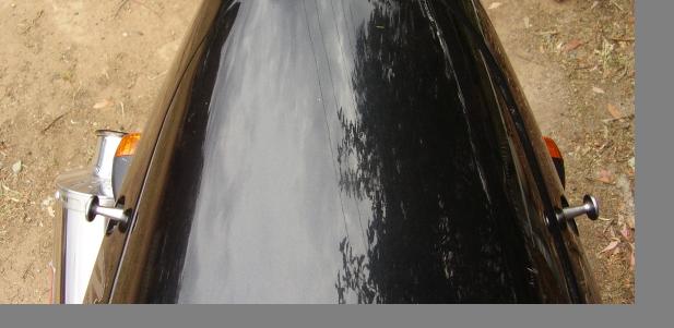

Looks much tidier imho. From above, you can barely see the lenses. There is enough clearance from the zorst as well........

- Get into it mate, its a really simple mod, only takes about 10-15min..

Gos, looks good mate, have you considered tinting up the indicator lens's and putting in brighter bulbs, I've seen it done on a black R1 and it looked clean ... no orange lens's hanging out to spoil the view.
I did that on the old 9, looked heaps better IMHO 8)
nobby wrote:Gos, looks good mate, have you considered tinting up the indicator lens's and putting in brighter bulbs, I've seen it done on a black R1 and it looked clean ... no orange lens's hanging out to spoil the view.
Mick C wrote:I did that on the old 9, looked heaps better IMHO
I had thought about the usual *clear* lenses, but not tinting them black........mmmm, I like a bit of black too (eh Mick :wink: ), whats the go with tinting ? And wouldn't brighter (higher wattage) bulbs upset the flasher unit ?? I like the direction this is heading....... :D

all you need is a decent number plate surround
..a KSRC one :D

Lookin good Gos,
now you just need to go and get your plate remade in black perspex ;)
