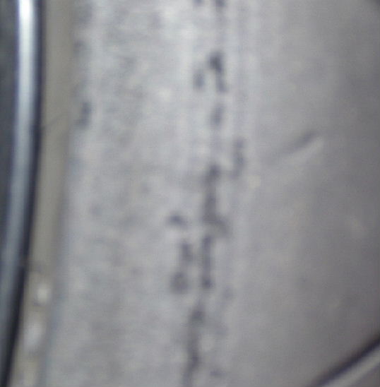

Here is a better pic of that front tyre. It must have been that last run up the Reefton which did it!!!!! :wink:
Faark me that was close!!
tyre delamination.jpg (67.06 KiB) Viewed 3413 times
I don't rate your version of a 'better' pic, nor does it do any justice to the damage you have inflicted on a harmless piece of rubber.
From what I saw this morning the tyre has balled up so bad, it tore small holes and the steel belt is showing :shock:

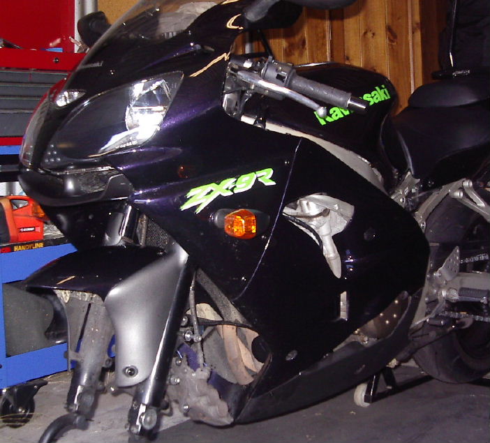

I got motivated and washed it during my lunch break! :D Clean again!!
clean again.jpg (129.19 KiB) Viewed 3364 times

Did you leave the front wheel in the washing machine :?:
swabio-ACT
Posts: 1635
Location: Brisbane, Australia
Post by swabio-ACT »
BladeBoy wrote:Did you leave the front wheel in the washing machine :?:
Nah he is just trying to save it from falling to bits... you are looking at the first ZX9 Unicycle right there! And ppl here think only Gos is into creating weird monstrosities! :D
