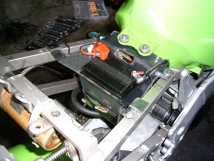

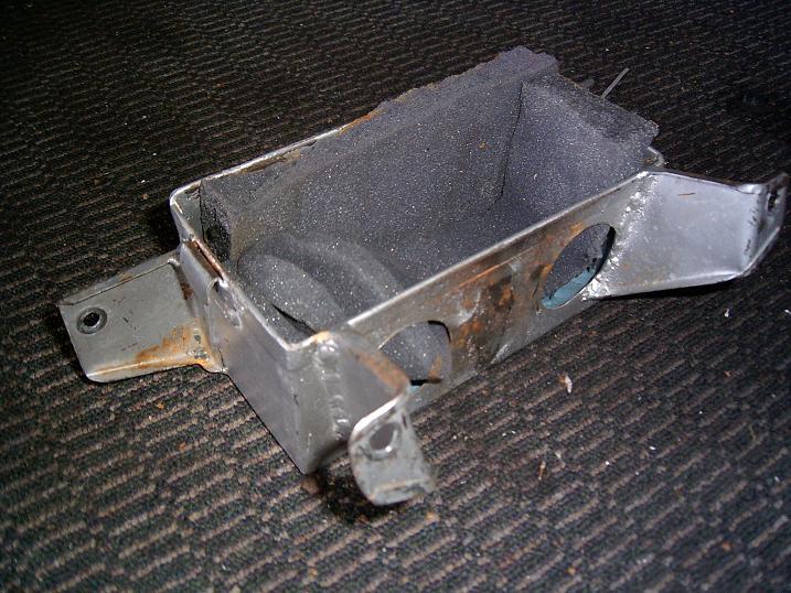

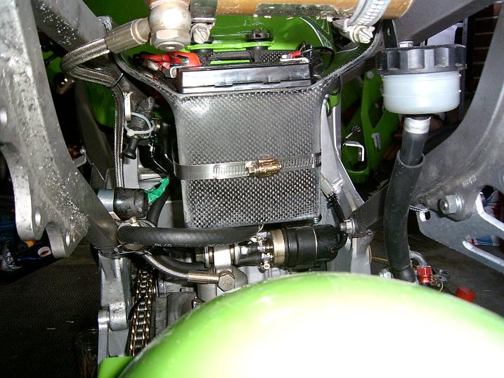

2. Joe (Greenblood) had this very nice looking carbon fibre battery box that didn't fit his 7 due to the piggy back shock, so as mine has a remote reservoir he handed it over to let me have a shot at fitting it. My thoughts were this would be a 2 or 3 beer job as it should be as simple as taking the massive rusty box out of mine and fitting this one. Unfortunately, like most things on this bike, it wasn't. I spent the whole day fitting it up, modding it, re-wiring, re-routing, and moving everything anywhere nearby. I had to completely change the fuel lines and reposition the igniter, starter switch and numerous other bits. I finally finished that this morning and it looks so much better and has hidden all the wiring and battery that was previously exposed.. Its also saved me few ounces in weight as I have a lot of bits now not needed.

that cf box looks really tidy...
good work!

Neat as :D

looks like a good home for the compression can too, I have a remote can tied to the subframe on the side but that looks a better idea.

and yep the multi use universal clamp is clamping the igniter (CDI) to the front of the battery box.. it was either that or a battery holder clamp..
I see them as structural zip ties.. :D
