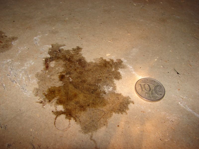

i came home and went out in the garage a few mins ago and noticed a mixture of oil and water under my bike.

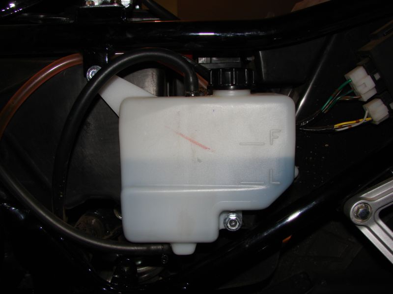

i took off the left side fairing on the side of the coolent resevoir.
i unscrewed the coolent resevoir and noticed what looked like dirty water in the drain hole at the base of the air filter.

its clear with light brown tinge to it.
viscosity isnt thick or sticky....just watery.

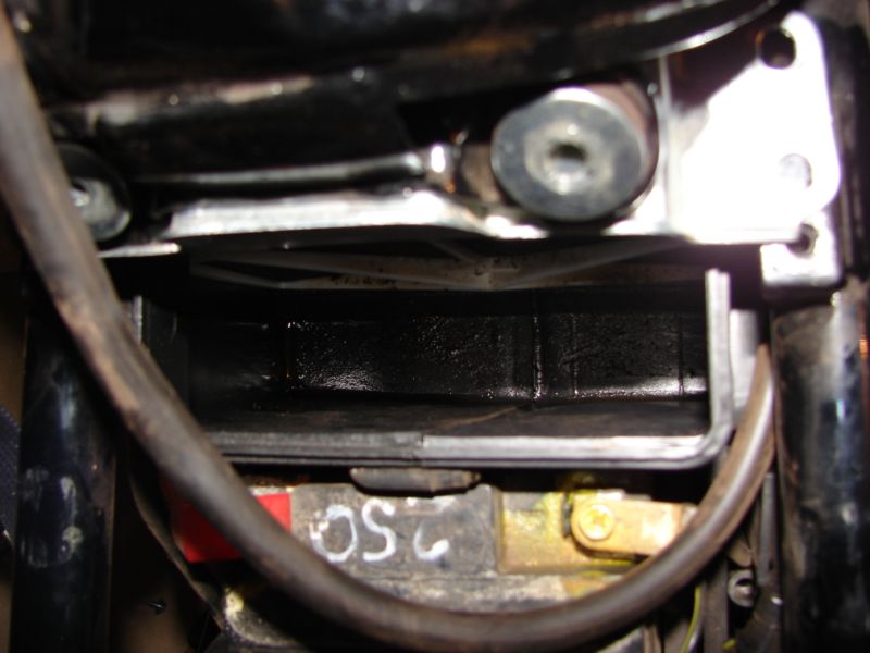

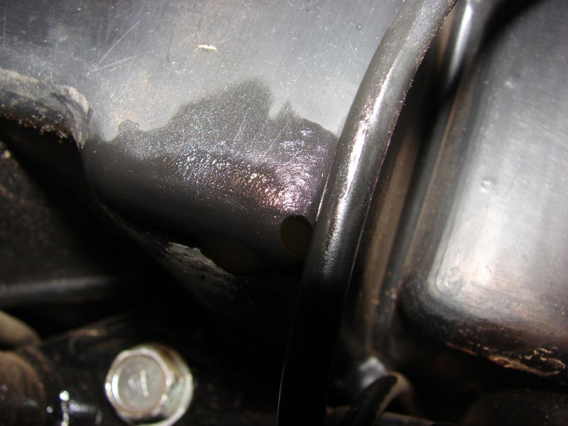

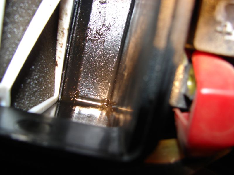

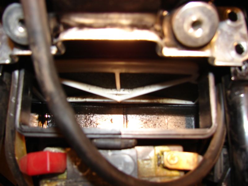

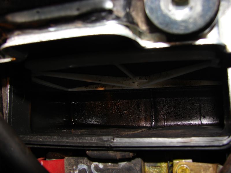

here are some pics
there is a close one of the drain hole which has the liquid in it and some shots of the inside of the air filter assy.
inside view of air filter assy with the drian hole in the bottom of the pic
the drain hole where it seems to be coming from

as your gpx riders will know the drain hole is directly behind the coolent resevoir
it leaks out the hole onto the coolent resevoir then down to the left foot peg and onto the concrete floor in the garage.

I reckon it looks like a little bit of blow by or Valve guide seal leakage sorry to say. Oil in an airbox is not a good sign! :shock:
If your oil level is too high, this can sometimes result in oil accumulating in an airbox as well......

it does seem like oil as i left a sheet of paper under it tonight came back now and it has some drops on it
