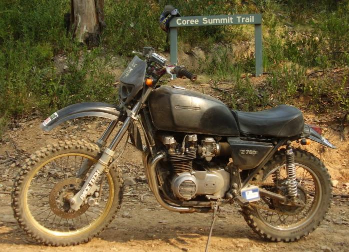

What a feeling !! This is a bloody hard piece of road on a good MX'er, let alone the frankenstein creation in the photos :lol: :lol: Having said that, it does actually handle pretty well in the rough stuff. The front suspension could use heavier springs (they are Racetech springs, set up to suit an XT600...), but it really works quite well, all things considered... :wink:
There is nothing like launching a z750 off a 3 foot erosion hump, and getting max air !!!! :lol: :lol: Its just *horn* let me tell you.... :P

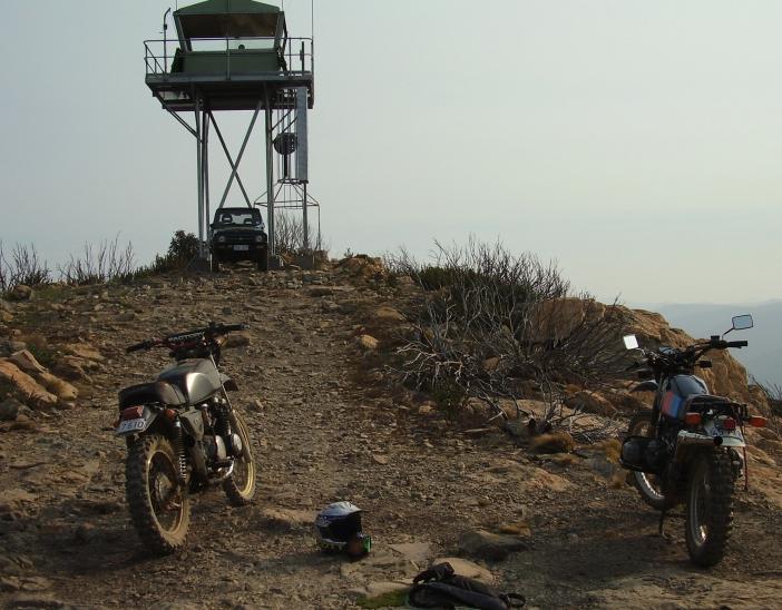

The Fire Tower at Mt Coree.....

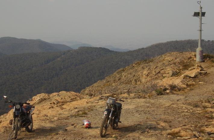

Looking back at the UHF tower.....the track can be seen at the right.....it drops pretty quickly from here....
Looking down at the bikes from the Fire Tower......

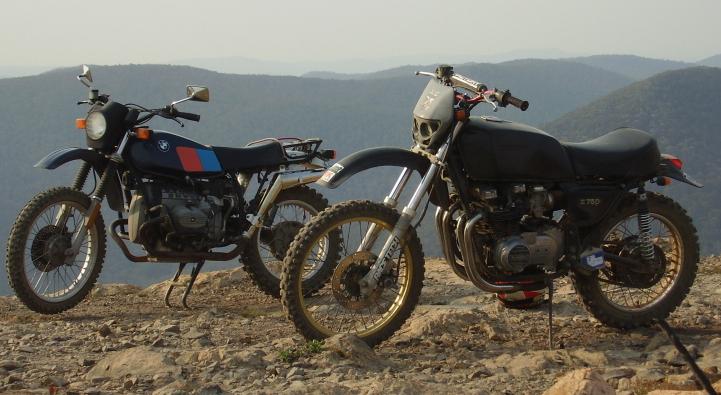

The 2 bikes at the summit of Coree, with the western slopes of the Brindies in the background....

pabs wrote:.....Have you though(I am sure u have) of leaning the rear shock's(top) forward abit maybe placing or welding new brackets with it,I did this on my old Mx'er it work a treat,specially on hill climbs & jumps when needed...
yes, absolutely. The shocks were set up (spring rate), based on the top-shock mount being moved forward about 50mm, and lowered about 30mm.....this would give the rear end the off-road *look* it really needs, as well as allowing another 40-odd mm of travel. it works well with the stock top-mounts, but does not have the full amount of travel (yet) - 165mm...... :shock:
I have some proper top-shock mounts that were donated from an old bent z650 frame that was kicking around, but I need to get the gussets *just right* before they get welded on. Its one area that has to be *perfect* as far as the positioning and welding is concerned. This mod I will probably knock over during winter next year, when the longer aluminium swingarm is fitted - proper MX style :P :twisted: :lol:

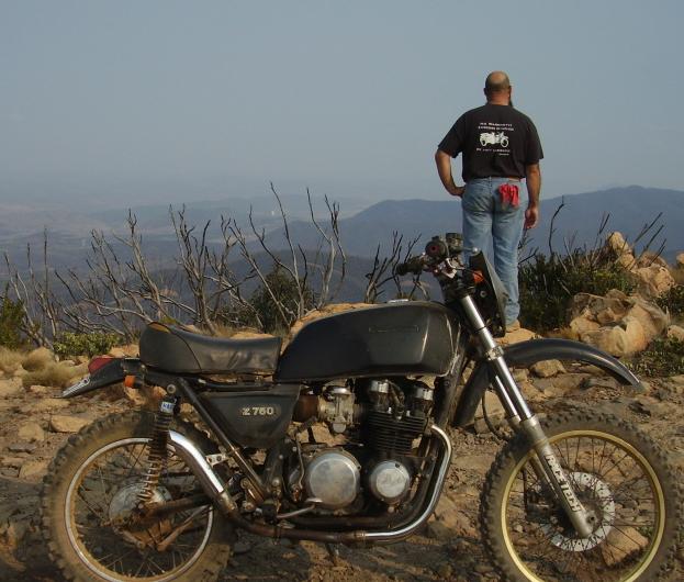

30 hours with Igor in the black t-Shirt :shock: and you weel out of the shed blinking into the sunrise with that...
it was meant to be this.....
