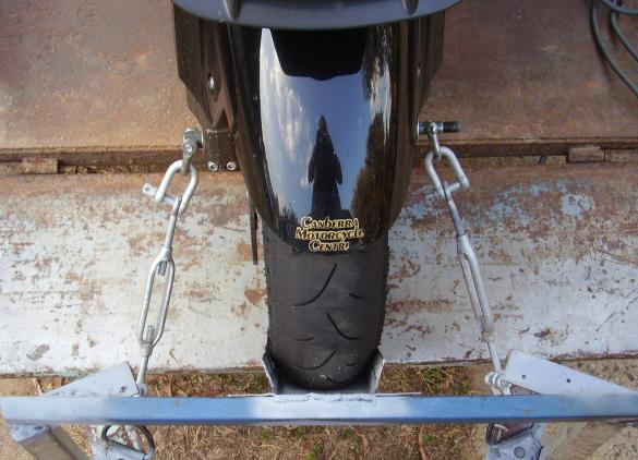

View from above.
View from above.

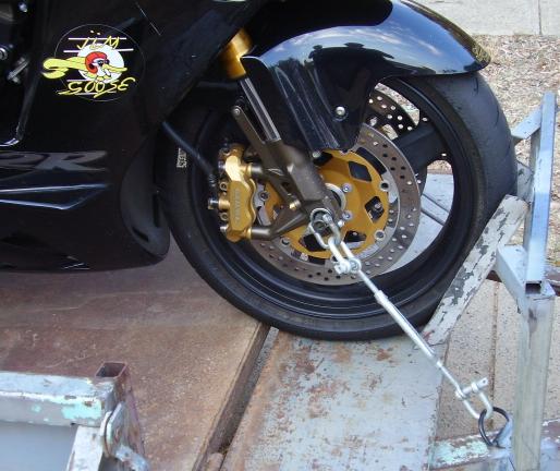

Close-up on RH side.

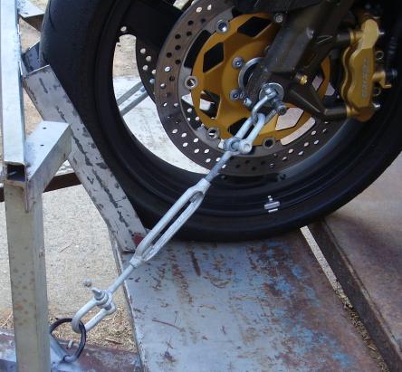

RH side
RH side

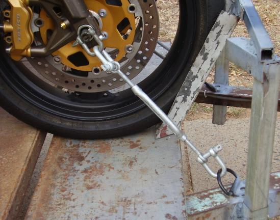

Close-up LH side
Close-up LH side

I know what you are thinking......that this simply doesn't look *enough* to hold a bike onto a trailer ? A couple of my mates thought so as well.....but it works really well. In fact, now that it has been tested on the barge (12), I can *guarantee* it will work fine for those light-weight sports bikes mate !! :wink:
You could grab the bars and give it a shake, and the whole trailer moves with the bike...... :shock:
Also saves the potential popping the fork seals too.
