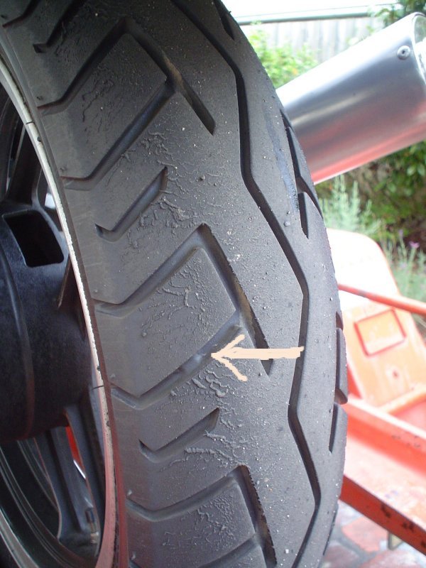

what is a tyre wear marker?
a pic might help........ :D
and no smart arse comments re the strips...ok
:wink:
PI Tyre Dsc00943_wearmarker.jpg (94.55 KiB) Viewed 3822 times
thans smitty for the pic, so this tyre marker will be located in all the tread? or selectively? must i roll the tyre and find it?
hidepenny wrote: thans smitty for the pic, so this tyre marker will be located in all the tread? or selectively? must i roll the tyre and find it?
HP
they are not in all grooves...see pic
so yes roll bike forward (or back) and look in the tread groove
'til you spot a tread wear marker
irrespective of the brand of road tyre..they all look
pretty much the same
(and btw....are on your car tyres as well)
hth

on the side wall of the tyre out near the tread you will see little triangles things they tell you where the wear indicators are located.
