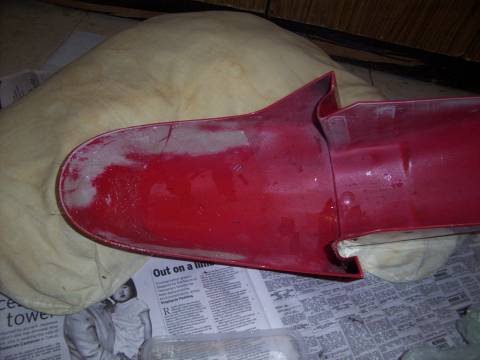

I know its not what your dealing with as its to do with fixing cracks first then spraying, but still, principles apply.
Heres how i fixed my old bikes front mudguard.
put the base resin coat on, then apply the glass and use a chopstick/skewer or something to push the glass down to et the resin thru

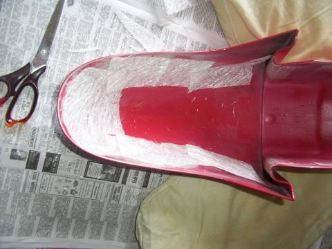

its important to cut ALL the glass up before you even think of mixing the resin. THose curetimes can really screw with you, plus just making a real mess if you get resin on glass your cutting.

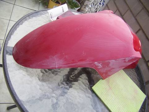

getting it ready with 800 grit paper
06 sanded pre glassing.jpg (25.31 KiB) Viewed 843 times

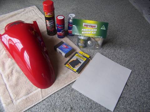

All the essentials to fixing cracked fairing with fibreglass. In hindsight i'd have some plastex in there to fix the crack, but i'd still reinforce it with glass.

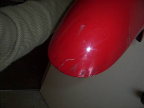

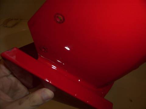

heres more of the damage, note the damage at forkmounts (typical of gpx bikes)
04 cleaning up-more damage.jpg (8.08 KiB) Viewed 843 times
heres a view of some of the damage i was fixing
03 cleaning up-showing damage.jpg (9.32 KiB) Viewed 843 times

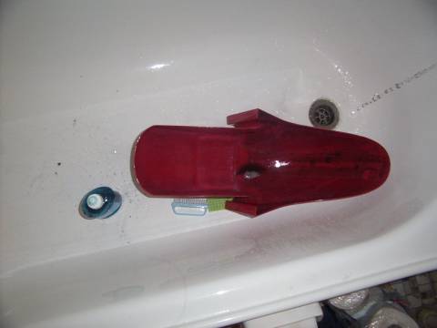

lots of degreaser (in the front yard) followed by heaps of scrubbing and detergent to clean it in the bath.

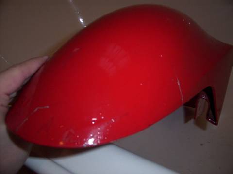

One of the front fairing cracks i was fixing.

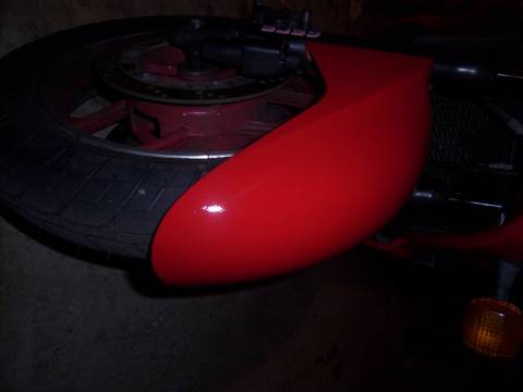

part two, this is more relevant to you. I used this as a guide on how to spraypaint my fairings.
it took about three or four attempts to get this right. I sprayed 2 LIGHT coats, waiting 5 mins between the coats to ensure thickness and smoothness, sanded with wet 1200 grit wet dry and then another two coats and two again of clearcoat.<br /><br />took practice,
took practice,
12 sprayedand sanded.jpg (10.79 KiB) Viewed 840 times

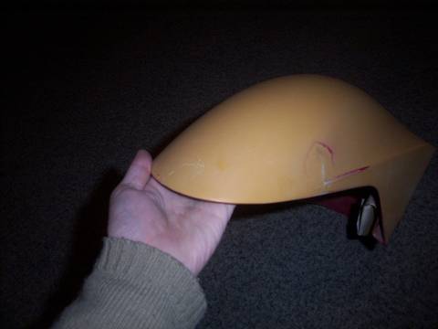

sand it smooth, to get rid of a crack on one side i had to sand through the paint and into the base primer used originally
11 sand till its smooth.jpg (10.56 KiB) Viewed 840 times

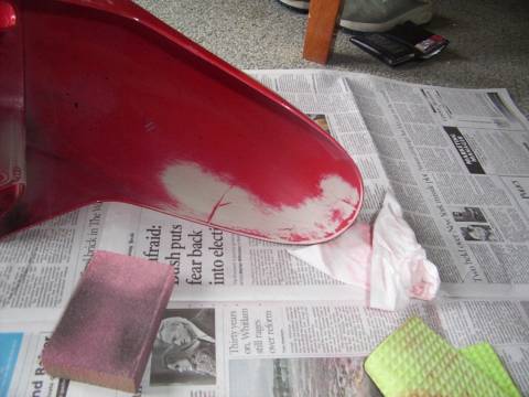

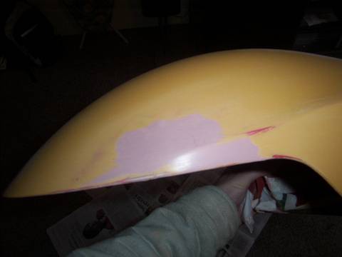

paint the spray filler, wait till its almost cured, then put another coat on
10 two coats of spray filler sanded.jpg (12.49 KiB) Viewed 840 times
sand the current coating down to remove the &amp;quot;gloss&amp;quot;, this ensures that the filler and the paint will stick.
sand the current coating down to remove the &quot;gloss&quot;, this ensures that the filler and the paint will stick.
09 sanding the current coat down lightly before bogging.jpg (21.9 KiB) Viewed 840 times
