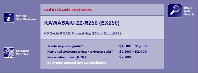

This is from Redbook, hope it helps...
I'd aim for the lower end of the range, you may need to buy tyres (they may have hardened and become brittle). You may also need to drain and clean out the fuel tank, drain the float bowls on the carbies and change the oil (three years of unuse and it may have become a bit chunky).
May as well factor in a coolant system flush and a new battery as well...
