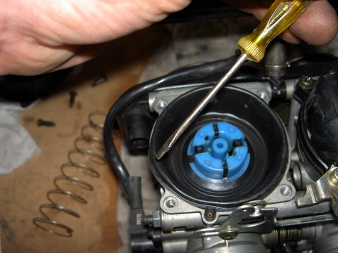

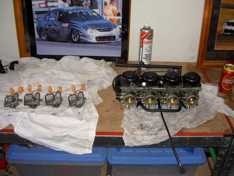

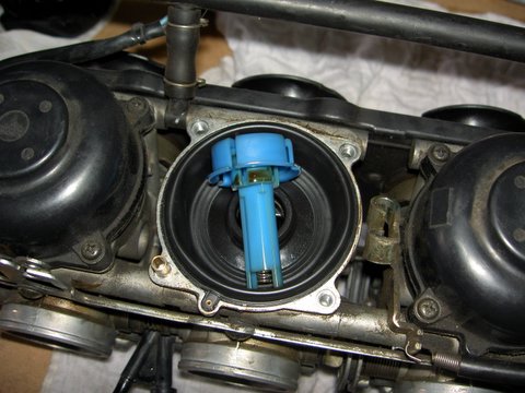

Tonight I have stripped and cleaned the carbs and measured the clearances. As far as this guys instructions go they are pretty good and a very helpful reference, however it is useful to use both links. As stated above it is best used in conjunction with a manual of which there are scanned copies of the relevant pages in the first link I posted.
I actualy stripped everything back to the rocker cover last night and so tonight I was able to get a start on the carbs. Now as far as my bike goes it was once my only form of transport for the about 3 1/2 years and it was used every day, but since I acquired a company vehicle 18 months ago it has now gone into semi retirement. In the last 18 months I have only clocked up 4500 k's through weekend use. the reason for me explaining all this? Well if you look at the pics below you will see a build up of goop on the blue thing* caused by the fuel in the carbs sitting stagnant and evaporating and leaving behind this varnish. The bowls also contained this brown molasses type stuff, however there wasnt any water in the bowls and overall the carbs were quite clean. In one of the pics below you can see the diaphram of one of the carbs refusing to sit back down where it is supposed to. I contribute this to the CRC Clean-A-Carb stuff I used and I think it caused it to swell a small amount. Live and learn - it eventualy was coaxed back into place - but from now on I think I will stick with shellite for this job, never had any probs with that.
As for the valve clearances well I spent alot of time checking and re-checking ( I think I checked each one over 6 times ) I am a little overcautious given this is the first time I have done this and it is clearly not something I want to make a mistake with $$$$$$.
So an hour and half of fiddling and checking the clearances I have settled on these figures;

- carbs3.jpg (37.38 KiB) Viewed 4241 times
- carbs2.jpg (44.3 KiB) Viewed 4242 times
- carbs1.jpg (43.47 KiB) Viewed 4242 times
