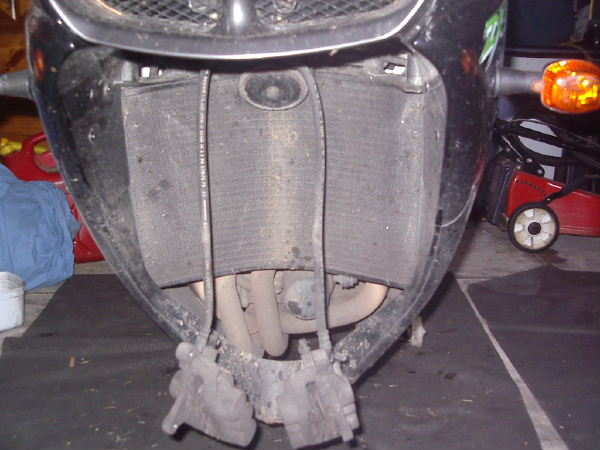

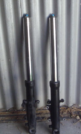

I pulled the forks out just then, ready to take up to Broadford on Sunday. Can't wait to get them back with some fresh oil and seals. I had been experiencing quite a different suspension action when cold and hot, meaning the suspension fluid is beyond it's use by date and getting sludgy. So some fresh oil will return more consistency over the period of a ride. I had it set up so that until you gave the suspension a work out and got it hot, it felt horribly hard. But it was the only way to keep it all together when the pace upped a bit. So I am looking forward to having it back so I can refiddle with the settings to get it how I like it. I may get him to rebuild the shock some time soon also. It fades as things get hotter too.
On closer inspection of the tubes, they look OK. So hopefully no rechroming or new bushes will be needed.
Pics or it didn't happen.
ZX9 forks.jpg (63.46 KiB) Viewed 3812 times
Forks removed.jpg (96.08 KiB) Viewed 3812 times
Strika wrote: Pics or it didn't happen.
OK then.....
Geez, makes me think I should do something about that little smudge on one of mine...I think it might've been the jumps that did it :oops:
Mick C wrote:Geez, makes me think I should do something about that little smudge on one of mine...I think it might've been the jumps that did it :oops:
I was thinking the same thing Mick, hence my desire to change the head bearings! :) But more likely it would take more than we were doing to damage the headstem bearings Mick! We were pussies! :lol:
