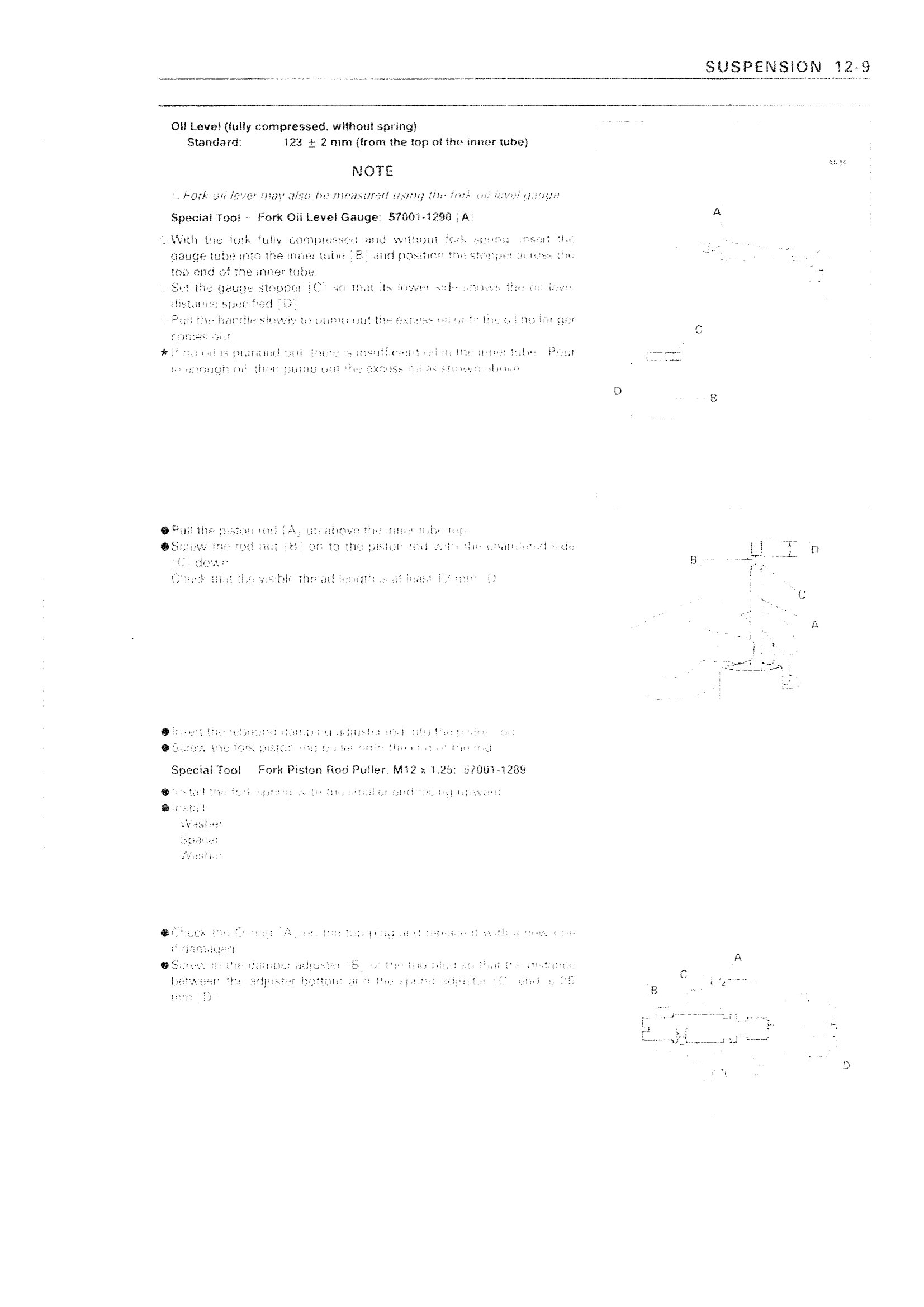

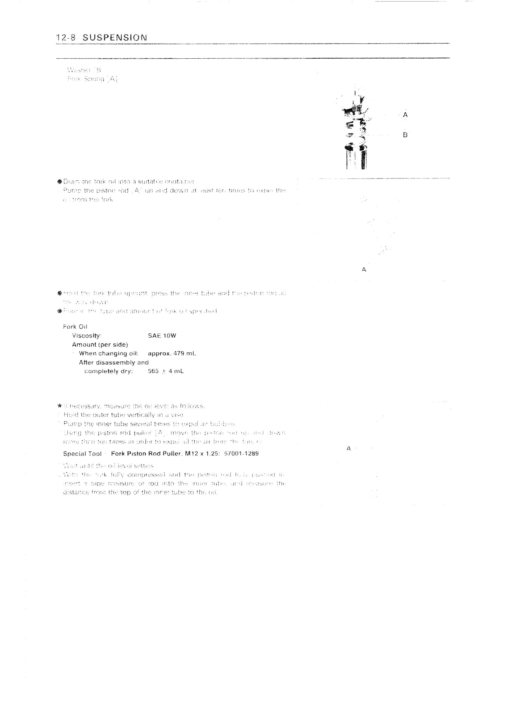

The number you need is the height from the top of the fork tubes..
Not sure what it is for yours but the 98 was about 150mm..

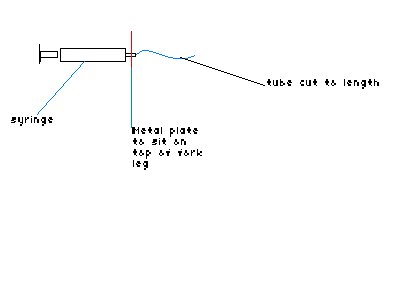

Ponti,
I'm sure you can borrow a syringe and a bit of plastic tubing which fits the end ?
I had a flat plate which I drilled a hole to suit the end of the syringe attached the tube to the other side and then cut the tube to the required length

here's an idea of the tool I made up
The flat plate sits on top of the fork leg and the measurement taken from the bottom of the flat plate to the end of the tube (123mm), suck the oil out using the syringe.......no more oil means you will have the exact measurement to the top of the oil
Smart eh ??
Smart eh ??

Yeh,
so long as you pump the piston in the fork "at least" 10 strokes you should dispel all the air and don't forget me and Ponti have "older" eyes and the numbers on tape measures get progressively smaller with each birfday - so once you have made the oil guage pump the only time you'll need to alter it is when you change your bike
