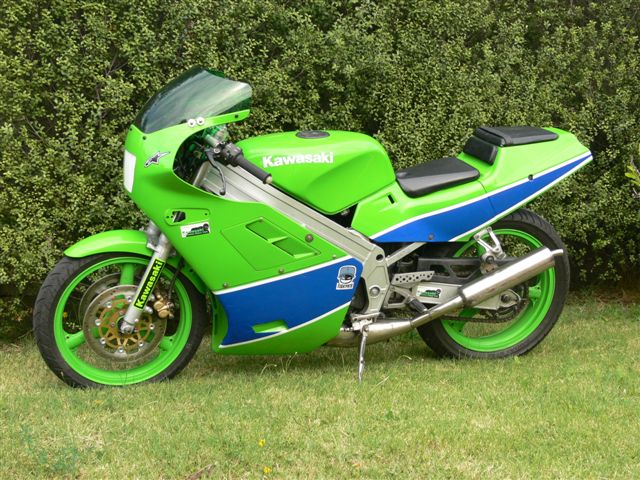

As some probably know I have bought a KR-1 to use as a track toy . Since it was made prior to '90 I thought this may as well be the place to formally introduce it to KSRC . Anyone who is interested might like to throw some helpfull tips on tuning for both the engine and chassis
Due to the limited numbers around now , spares might be scarce but sourcing them will be part of the fun in running this little beastie .
Have found an interesting site in the UK , http://www.kr-1s.co.uk that boasts about 150 members and are really into kr's and have provided a heap of information .

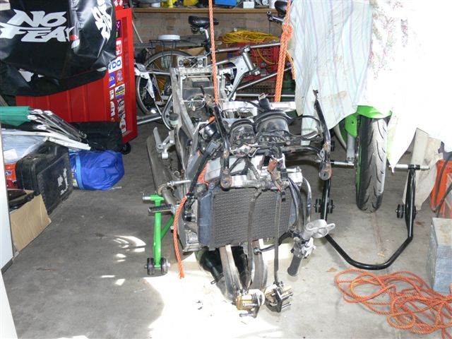

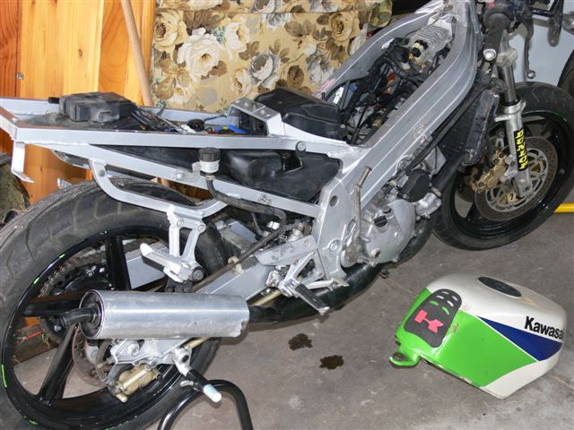

So far after bringing the new toy home it has been stripped of anything to do with road use . Any wieght saving is good right ? And speaking of weight , shit its light :lol: After shuffling the 9 around the garage you nearly throw the KR on its side moving it :lol:
Next the forks were stripped to replace the fork seals (amazingly available off the shelf at Bri Kwa ) With help from Groggles Jess and Duane a "special tool " was constucted by brazing a bolt onto a section of pipe to hold the internals while undoing the allen bolt thru the bottom of the forks . Easy .... only if you can hang onto the insides :lol:
A clean up and reassembly with the spec'd amount of 10wt oil .
Springs measured up to standard but will get some firmer ones when bucks allow .

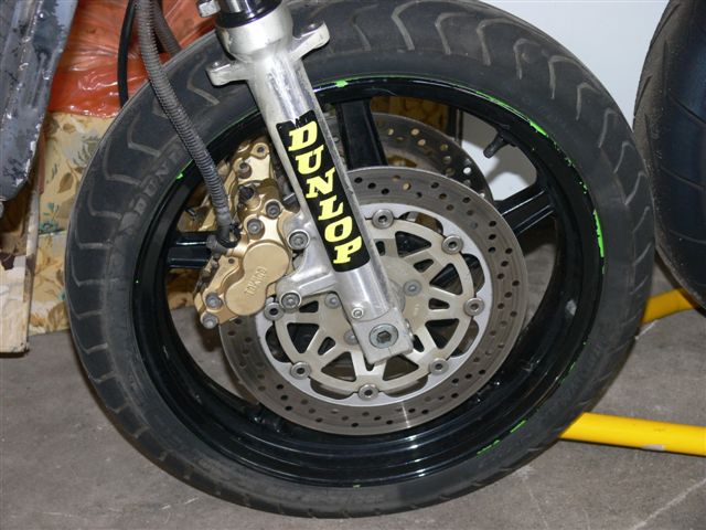

As purchased the front discs were rooted , so a search for replacements was on . We are learning as we go and with 20/20 hind sight I think I would have gone a different route but time was pressing as a track day was booked for Broadford (10-02 see track section )
The KR-1 has 280mm rotors and calipers that are unique to this model , the later KR-1S has 300mm discs and calipers that have been on a number of Kwaks including early ZX9s .
Prices for new discs is scary but found that Planet Discs had some replacement ones that he mounted up on KR carrriers for $400
Another issue with the unique nature of the KR-1 is that the pad availability is quiet limited with only organic type available (at this stage , might be able to get GoldFren in ceramic carbon?? and am waiting to hear back)
Reason for all this waffle about brakes is that at the first track day the brakes felt "uninspiring" .
Hope to get a set of braided lines made up in time for the next track session and I hpe that may make a bit of difference to feel .
Tyres are high on the wish list and want to stick a set of Dunlop GPR70s on ASAP .
This is suposed to be a cheap way to hit the track but it is now turning into a passion for fidling and modding :lol:
A set of KR-1S pipes are available from a SA wrecker and will go on as bucks allow . They are supposed to be very very good for developing power (as good as any aftermarket chambers) but are a bit heavy as they are double walled pipes .
Jetting is stock and will probably stay that way for a while . Oil pump will also stay for a bit longer too as it seems to work fine and have yet to hear of any inherent problems with it .
Putting Castrol TTS through it .
Stay tuned :D

KR-1 025.jpg (110.46 KiB) Viewed 6932 times
Trained Technicians and Kawa special Fork tool
KR-1 002.jpg (67.46 KiB) Viewed 6933 times

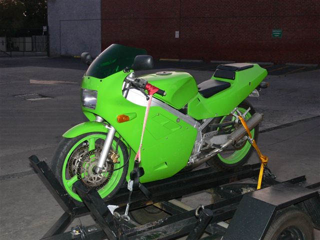

2 Days Later
2 Days Later
KR-1 008.jpg (80.24 KiB) Viewed 6935 times
Coming Home
Coming Home
KR-1 003.jpg (58.82 KiB) Viewed 6935 times

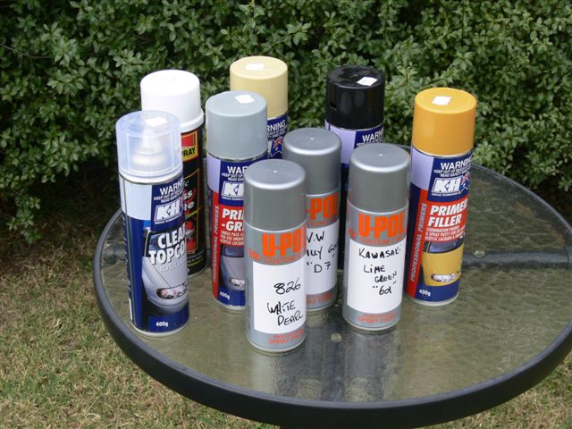

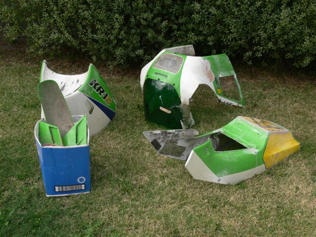

Have got stuck into repairing the fairing and modding the tail section for track use .
Have stuck the side panels to the tail unit and glassed over the pillion seat . Worked on filling in the lighting holes with glass and bog . Have to reform a couple of "ears' for the screen as they have been snapped off .
Purchased a couple of spray cans to paint the things in the same scheme that was originally on it , or new enough .
Having a ball . :lol:
Any one contemplating buying automotive paints in Melbourne should visit "JUST PAINTS" in Cochranes Rd Moorabbin .
The guy was so helpfull and full of advice for the painting , preping newbie . And he gave me a discount too .
More cans than a KSRC party
