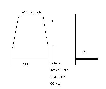

I am looking at buying a Ventura Rack and Bag system for my recently purchased ZZR-250. I've been looking on e-bay at some racks and bags but haven't seen any yet for my bike and am now considering the option of getting new L brackets but getting the bag and rack of ebay or similar, the only thing is no one (inlcuding a couple of kawasaki dealers) seam to be able to tell me what size the rack is that goes onto the ZZR-250 is. So if anyone can tell me the size and/or spacing of the L bracket ends it would be greatly appreciated.

Here is the dimensions for the L bracket, tube has an ID of 16mm, bolts are 10mm from memory
---------------------------| 110mm
----260mm-------------|
________________|
-o------o
125mm
The gap between the centres of the 2 brackets (bracket - seat - bracket) is 315mm
The bracket that the bag goes on is as pictured in attachment.
