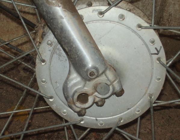

That front-end is what is known as a 'Hatta' fork - the front axle can be placed in 1 of 3 positions - either leading axle (in front of the forks), centre axle (in line with forks), or trailing axle (behind forks) - this was to achieve a range of handling options, depending on the type of riding being done.

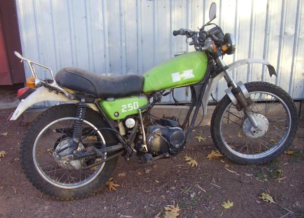

Don't be fooled by the 250 sticker, thats just for rego !!  It is a 350cc, the top-ends are interchangeable between the smaller 250 and this one....

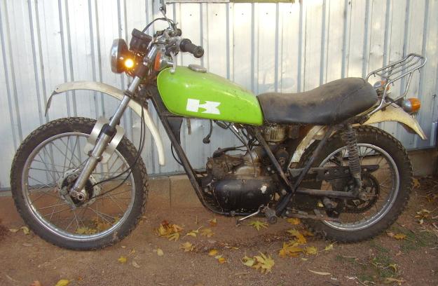

still got cobwebs everywhere....

Kawasaki's infamous 'Hatta' fork.....

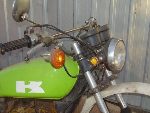

all the good stock bits are still there....headlight, reflectors, stock handlebars, levers, etc etc

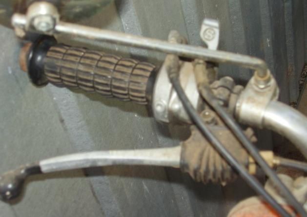

close-up of the stock bits - that lever with the 'S' is the choke lever.....'S' being 'Start'......these sort of bits are really hard to find....

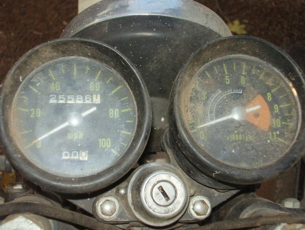

Original Miles !!  Never been Dropped !!!!   Only Ridden on Sundays by a Little Old Lady on the way to Church !!!! ........

Those clocks look a lot like widowmaker clocks....
they are very similiar........even in the paperwork I have scrounged off the Net from the US, it mentions how Kawasaki used the same parts across a multitude of models, for economy of scale.....
