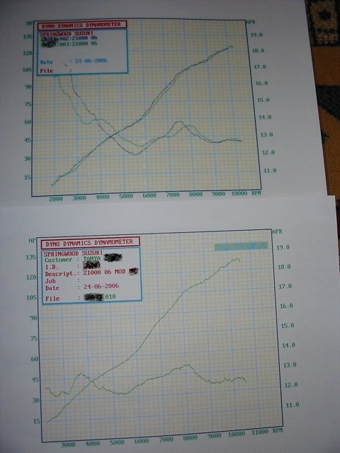

- ttc
- Team Black
- Posts: 2893
- Joined: Fri Nov 19, 2004 2:59 pm
- Location: Brisbane
Re: K&N + Yoshi with No PCIII
Without the power commander, top dyno run, air fuel ration starts at 17 to 1 and goes all over the place
it's been remapped again since the bottom one, air fuel ratio is a steady 12.5 across the rev range now.
Places here do power runs for about $30, which is all you need to see the air fuel mixture.
