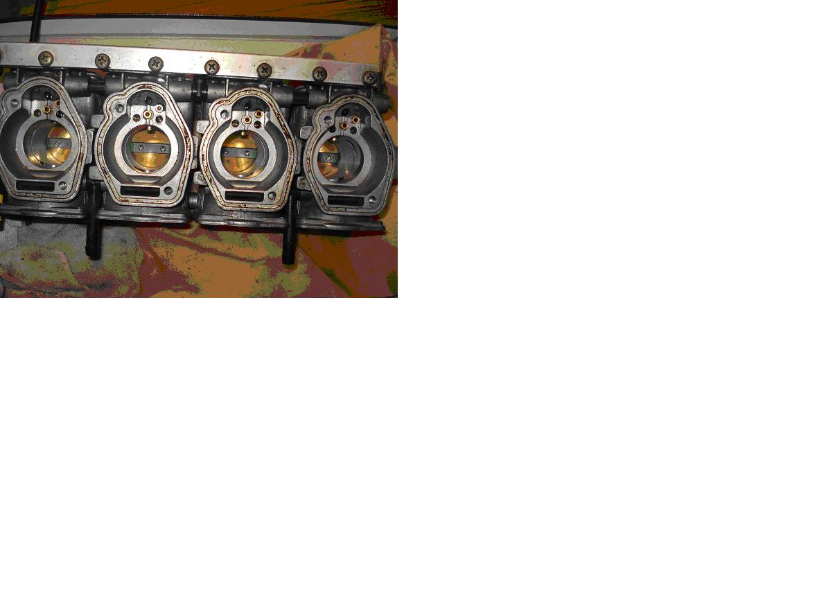

Bloke at garage found one of the carbs had been replaced at some point, and the brass fuel inlet nozzle (in the carb throat) was different to the other 3, made it a bastard to get them sorted ... I am looking for a single carb now, waiting for pics from a seller.
He managed to get the carbs synched, set the float levels OK, but he said when it's hot the bike is hard to start, but can idle for ever without overheating ....

I rechecked the pics of my carbs when I cleaned then out, and the inlet is shorter (Not longer, as I said earlier, sorry) :
See the LHS carby, shorter inlet Nozzle into cylinder #1 throat ....
