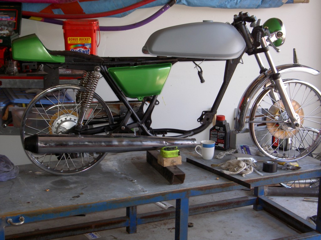

Had a thread going regarding this but it was lost in the site crash so here goes again.

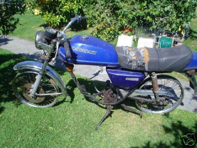

Bought this for $20 off e-bay Then came across this one for $150. A runner. Complete and unmolested, just well weathered.

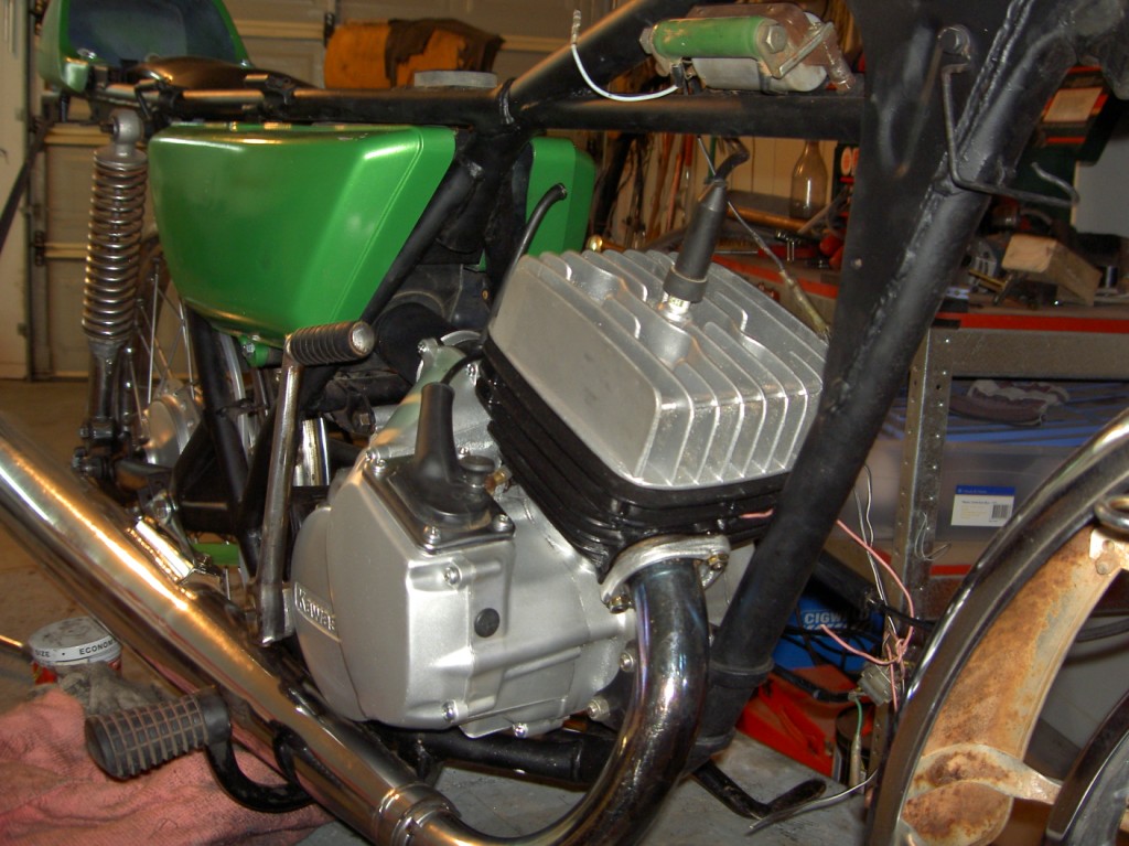

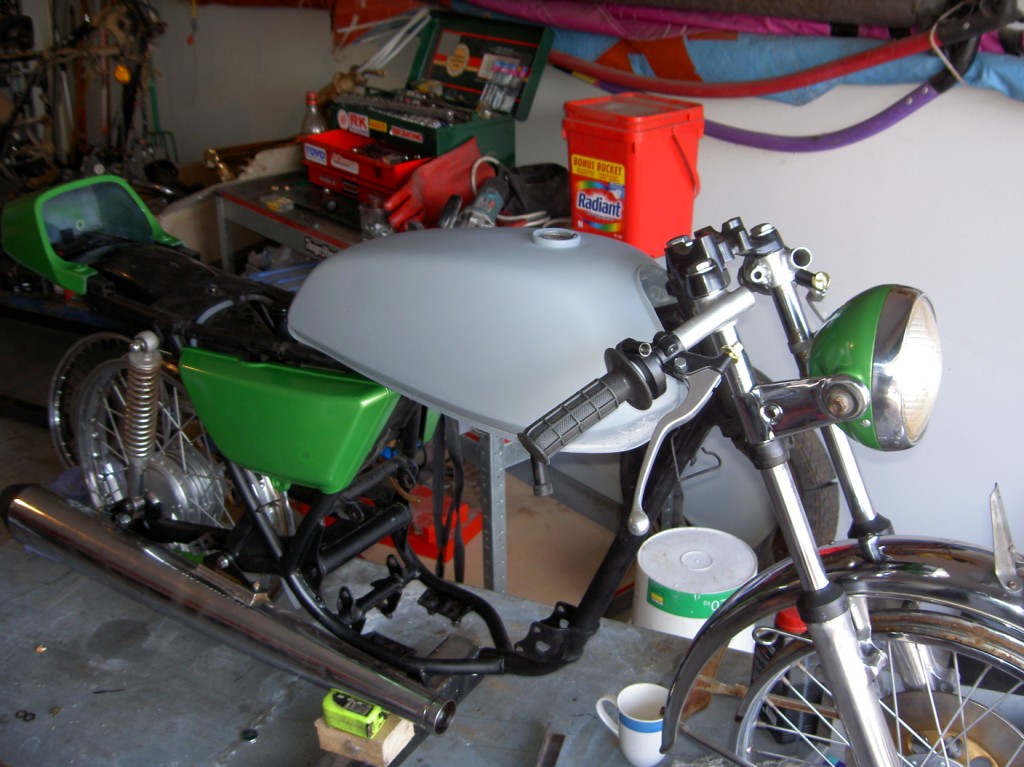

Have been ripping bits and pieces apart cleaning, painting, polishing, fixing and replacing. Until now it is looking a bit more like this.
Engine has been cleaned up and painted, just need some new machine screws for the cases before I put it back in.
More rubbing back and paint required on the tank and covers. Total cost so far just under $320.
Still need-
Rear shocks
Tyres
Chain and sprockets
New lights and switchgear
Battery
Front brake caliper
Still need-
Rear shocks
Tyres
Chain and sprockets
Battery
Front brake caliper

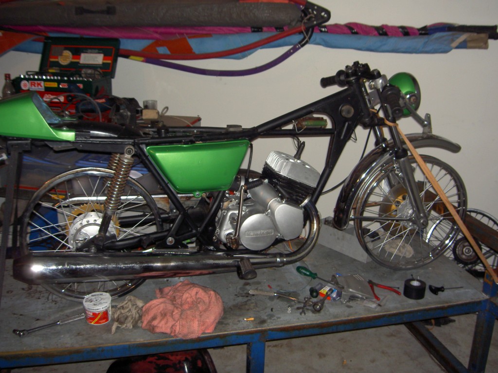

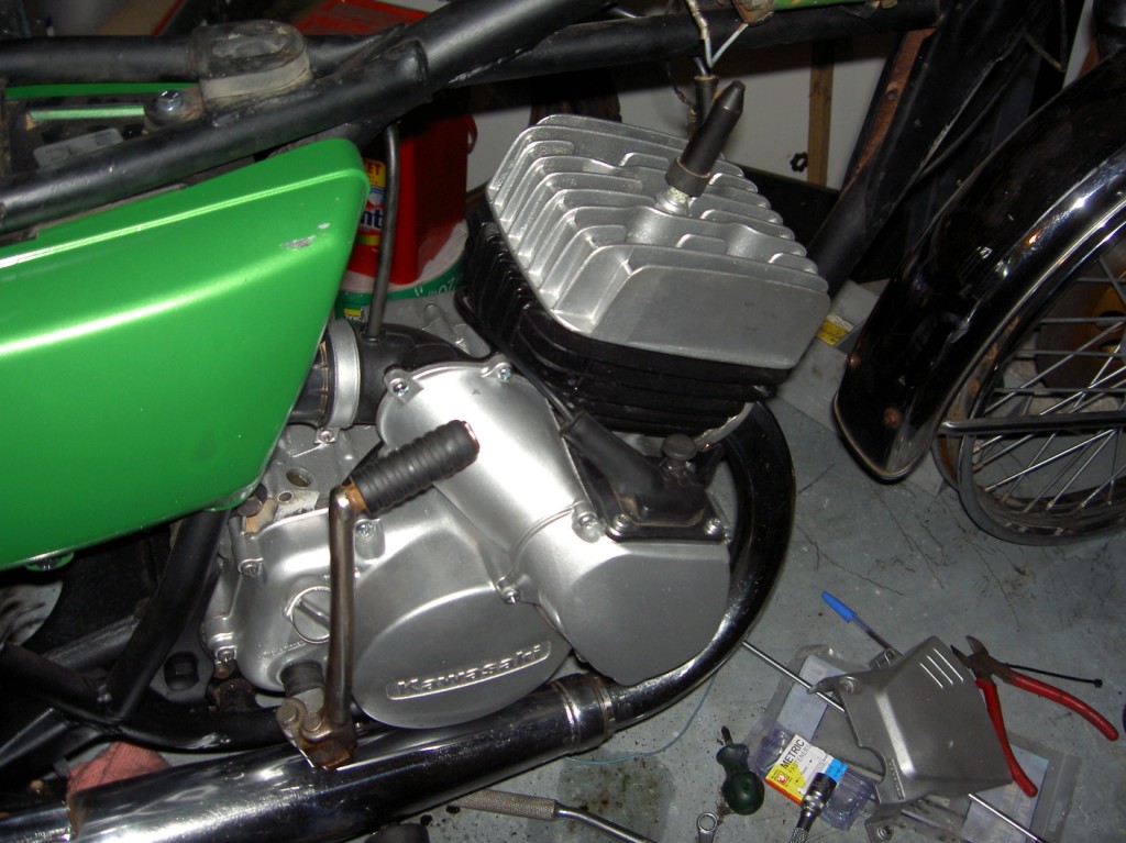

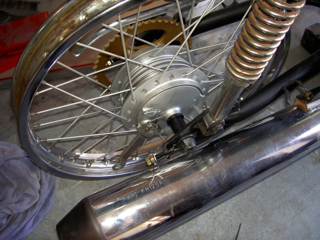

Engine back together today and re-installed. Whiff of fuel and ringa ding ding. With any luck it should be on the road by xmas. So far its cost less than and is way cooler than any pocket bike
Cant wait to piss off those rusty rear shocks. The kickstart may either get cleaned up or tossed for a new one. The rusty bits realy show up in the pics

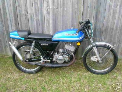

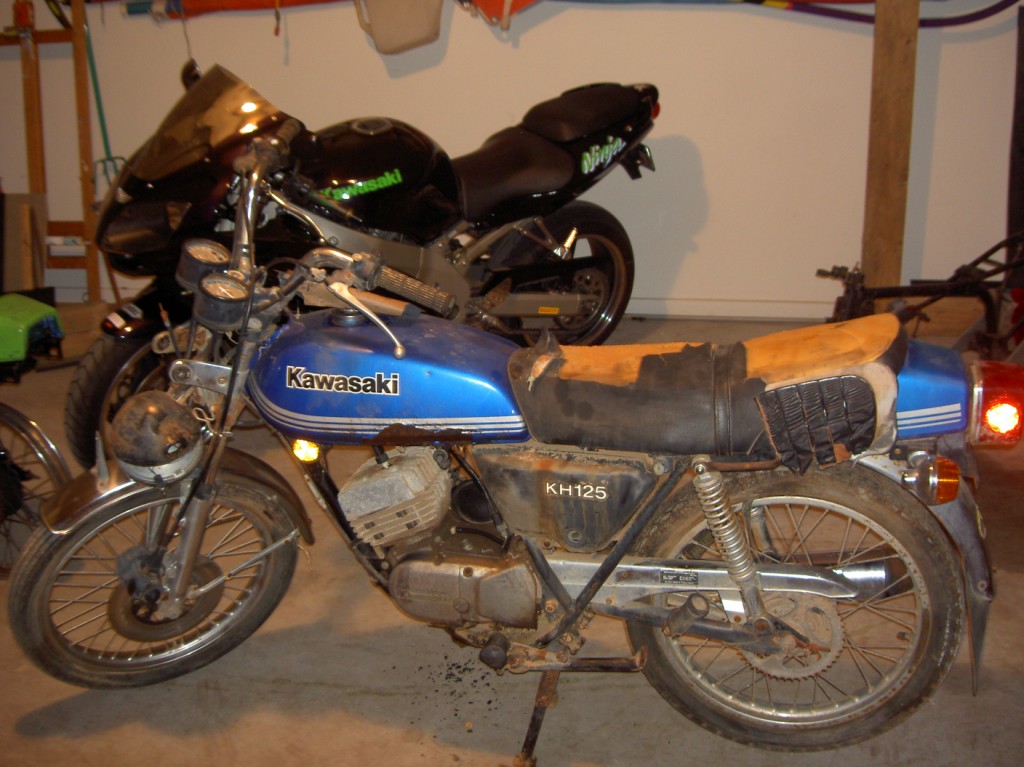

This is amusing. There is a reserve posted on this thing!
Three interesting things I have gleaned from the photographs though;
1. TZR 250 hydraulic brakes will fit up
2. The rearset configuration with rear brake linkage
3. A visual of how I imagined I might do the seat - not impressed with this and will do better
Oh and hows the exhaust? Why would it require such length? I know that expansion chamber design is somewhat of an artform but why is there a need to have the length in the pipe?
And clip-ons look way cooler than those flat bars

When it comes to two strokes, the entire exhaust is a bit of a black magic. I suppose it depends if the owner has done any testing on it. I see it has a race plate on the front, so I assume the owner was looking for more power... somewhere.Slow and wobbly wrote:Oh and hows the exhaust? Why would it require such length? I know that expansion chamber design is somewhat of an artform but why is there a need to have the length in the pipe?

Back in the good old days of unmuffled strokers, that pipe would have had a short length of 15-20mm pipe at the end called a 'stinger'. No muffler required.Slow and wobbly wrote:.....Oh and hows the exhaust? Why would it require such length? I know that expansion chamber design is somewhat of an artform but why is there a need to have the length in the pipe?....
The entire philosophy and design of a good stroker exhaust is based on the 'tuned length' of the system. (4 strokes also have tuned length issues, but not the same as strokers)
That system pictured is just bodgy. The header pipe is far too long (looks like a stocker), and that means everything behind it is just too long as well. The muffler hangin' off the end is there for sound examinations only........it looks like a small-capacity MX muffler that has just been tacked on the end ?

I think it looks ridiculous becuase its been ripped off another bike. There's plenty of 2 stroke software out there, you can make or have made a custom pipe for any 2 stroke engine based on the specifics you put in and the dimensions it calculates for you. I was going to make a tuned pipe for the whipper snipper! But who could really be farked. I found this site was pretty interesting http://macdizzy.com/2stroke.htm" target="_blank. Nice resto job btw, it looks great!

Do you mean TZ250? Because TZ250s go back a lot longer than TZR250s. The TZR only came out in 1986 or so and the caliper looks nothing like that, it's a four piston caliper thats interchangeable with the 99-02 R1/R6 caliper.Slow and wobbly wrote:This is amusing. There is a reserve posted on this thing!
The length of the exhaust is dependent on what revs you want it to work at. For low revving engines you need long chambers.
