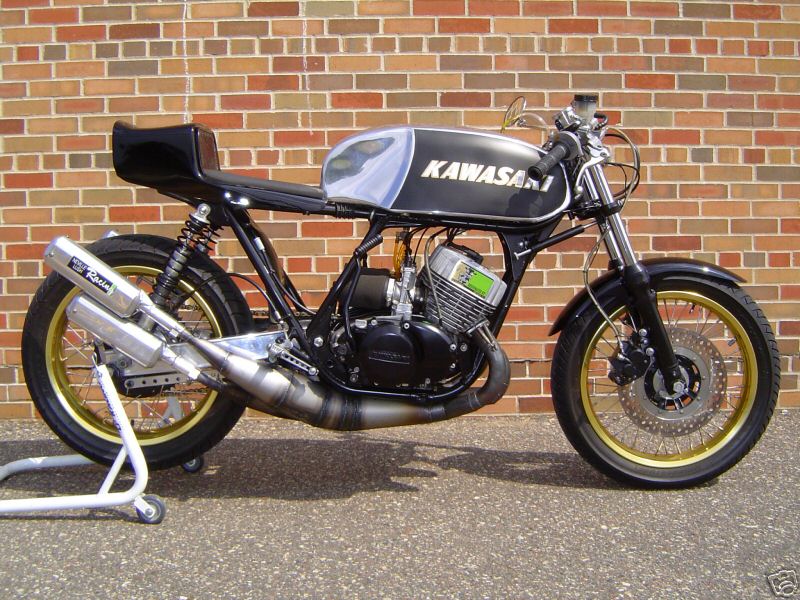

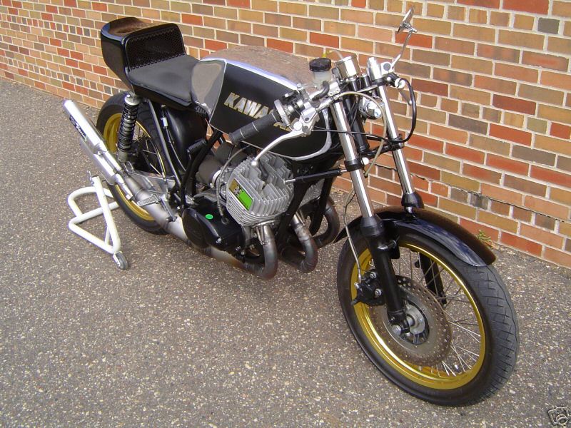

I saw this heavily modified H2 on Ebay, stopped watching after it got close to $10000us. Very nice though.
- bb2a_3.jpg (134.73 KiB) Viewed 28638 times
- bc48_3.jpg (130.71 KiB) Viewed 28633 times

yes, the LTD models are basically the same as far as engines and frames are concerned. They normally have poxxy King/Queen seats and apehanger bars, but all that stuff can be changed easily.
Thats a nice lookin' H2 !
