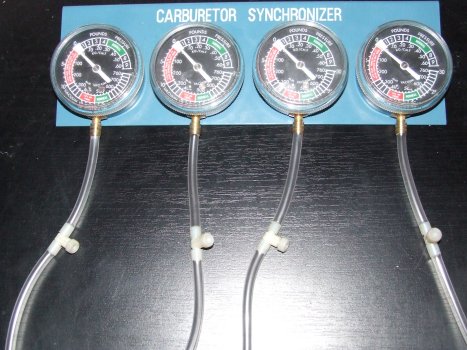

Stealthassassin wrote: Do they just attach the gauge up tp the float bowl drains to get the balance correct?
That's to check the float level. ;)
To balance them you need to connect a gauge to the engine side of the carbies.
I was lucky enough to get my hands on one of these;

Cool, thanks Daisy.. Where do they attach on the engine side of the Carbies?
Daisy
Posts: 1394
Bike: GTR
Re: What Next? [ZXR250A 1990]
Post by Daisy »
Not sure about your bike, but usually on the top of the rubber manifold there are nipples with various vacuum hoses - fuel tap etc. You simply connect the gauges to each of those,making sure that you still have some way of fuelling if you're using the bikes own tank and it has a vac tap. Then at operating temp, making sure the idle speed is correct, adjust the carbies in pairs. I think for mine it was left pair, right pair, and then synchronise them with the centre screw.
