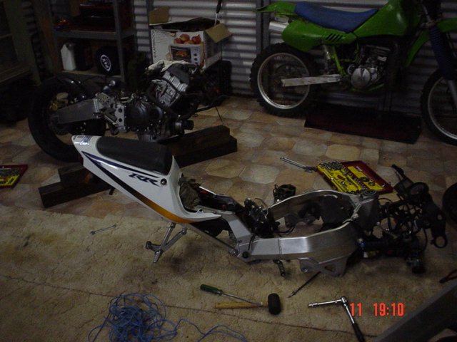

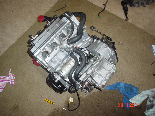

its not as hard as u may think....
we had my cbr apart... most of the wiring loom has plugs that will only go to one plug..if u kno wot i mean... if in doubt label everything as u go... and take plenty of digital pics in case u forget sumthin!!

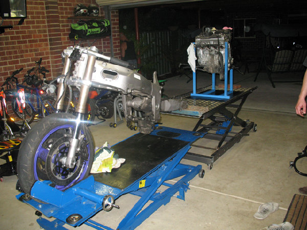

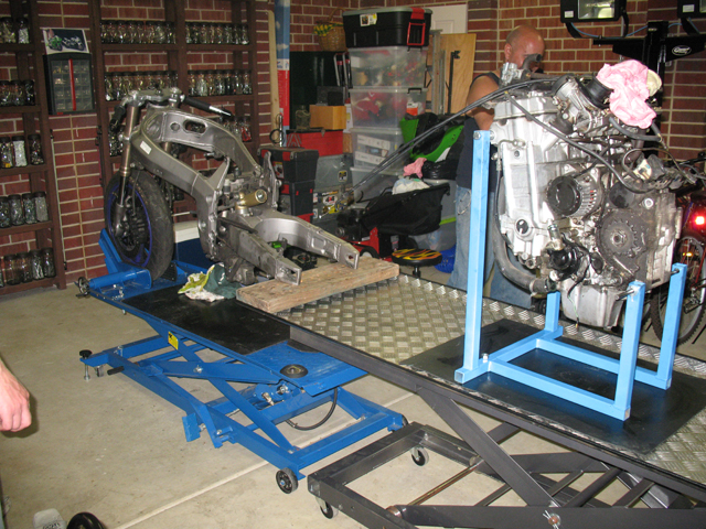

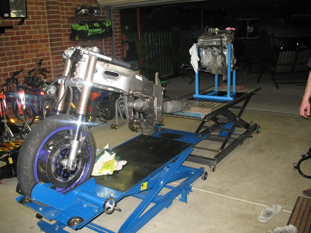

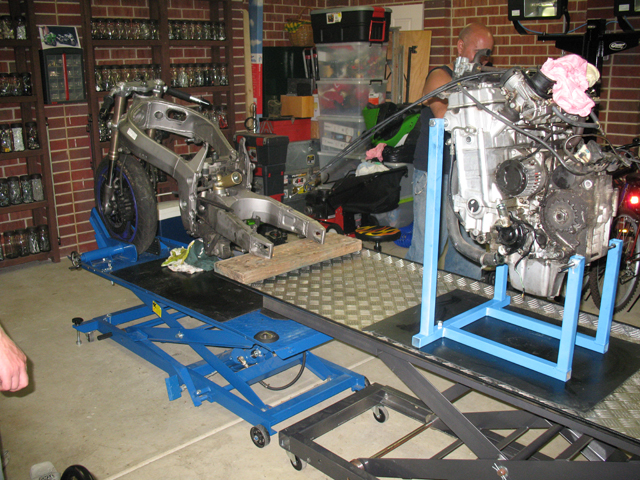

Well, engines out now.
Lots of little things needed to be done before I could get it out. Didnt realise some of the stuff I had left on.
Turns out if you dont take the chain off before you remove the engine sprocket it will become a S.O.B to get off later (Or still have to stay on until I find another way...)
Heres some pics of how it looks now. Sorry to all you guys who dont have a stand...since I have 2. The grey one I made at work. Your not going to beleive me when I say this but...It cost a super cheap $100 odd bucks to make ($65 jack & 30 in steel). Ill upload the plans when I finish drawing them up from my napkin doodles.

Re: Removing zx7 engine
Wow you have so much space, and it's clean. Our shed is filled with shit and isn't sealed well, so not only do I not have space for sensible arrangement of the TZRs bits, but everything gets covered in dust and small tree/bush bits.
I wish I could say the space was mine, but in actual fact its my boss'. We work on the bike together.
