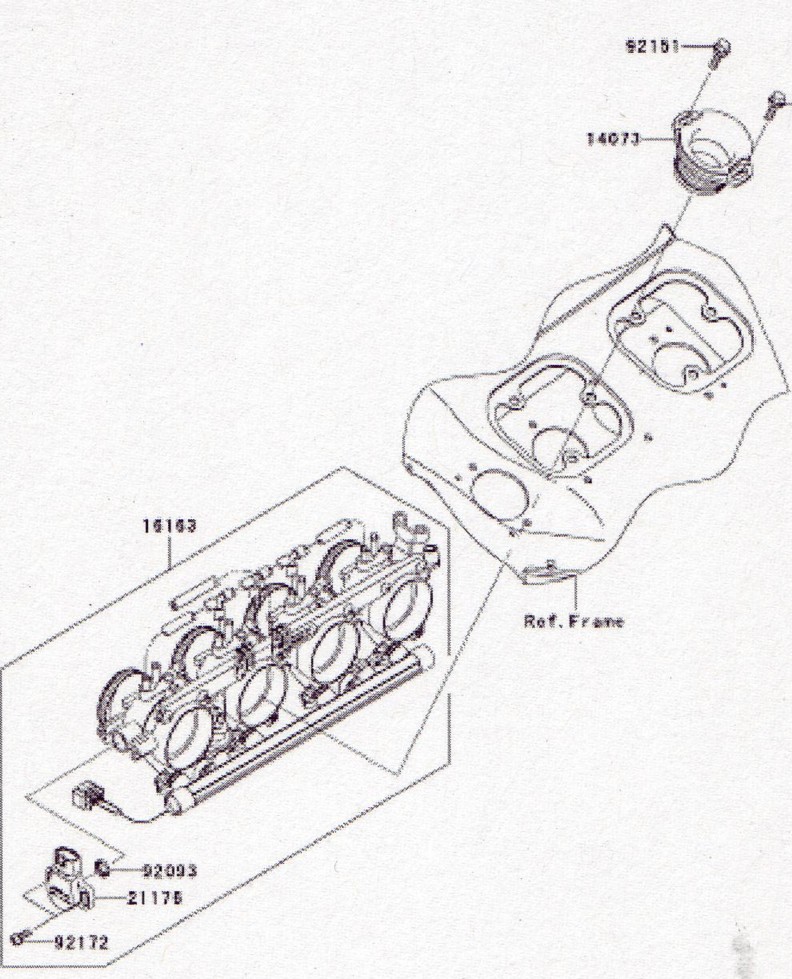

Re: ZX12R secondary butterflys
Post by Che »
I have the 2000 ZX12 and definitely no secondary butterflies.... 8)
zx12 injectors.jpg (197.96 KiB) Viewed 5209 times
Race Hard Or Go Home

Secondary butterflies are fitted to ZX12R's, as far as I know from the 2004 model onward. The early models (A) did not have secondary butterflies fitted, and this is one of the supposed *upgrades* to the B models :roll:
The secondary butterflies are controlled by the ECU, and do not fully open untill 7,000rpm under standard operating conditions. They are barely cracked open at idle, and even at 5k, are only open a tad !
They present a large restriction to air-flow past the primary butterflies (located in the same position as the early 12's). But its not all bad news - on stock motors, the secondary butterflies actually smooth out the throttle response quite a bit, and help the motor respond well down low, without any 'hiccups'.....
The bad news is that for throttle-jockeys, the restriction means that you don't actually get a Wide Open Throttle (WOT) position until 7k and above. On the highway, this is a bit above normal highway speeds (we all observe posted limits don't we...) :lol:
I removed the secondary butterflies on the MFP12 before the ride to the WSB earlier this year. The difference on the highway is phenomenal - you get *instant* response and a huge surge of power anywhere above 4k.
But like anyything, you do trade away some things to get this great response at all highway speeds above 4k.........
There is a bit of a flat spot down low, which is worse when the motor is cold - the secondary throttle butterflies act like a 'choke', and allow a normal motor to pull away cleanly when not warm - This *is not* how these motors respond with the secondary butterflies removed....but the mid-to-high end response justifies taking them off !!!! :twisted: :twisted: :twisted:
*NOTE* - If you do intend to remove these, be really careful. One false move, and you *could* see a small set-screw dissapear into the head !!!! Use a magnetic screwdriver, and stay off the piss for a couple of nights beforehand !! :lol: Its literally a 15-minute job, you can see the secondary butterflies inside the inlet tracts easily, and there are 2 screws per butterfly.
I have often considered putting mine back on for normal riding (ie commuting), and just removing them for track-days and long trips like the WSB ride etc. The better throttle response around town is worth having them stay where Kawasaki put them.
They are also fitted to ZZR1400's as well. ;)
