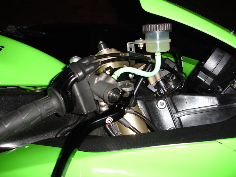

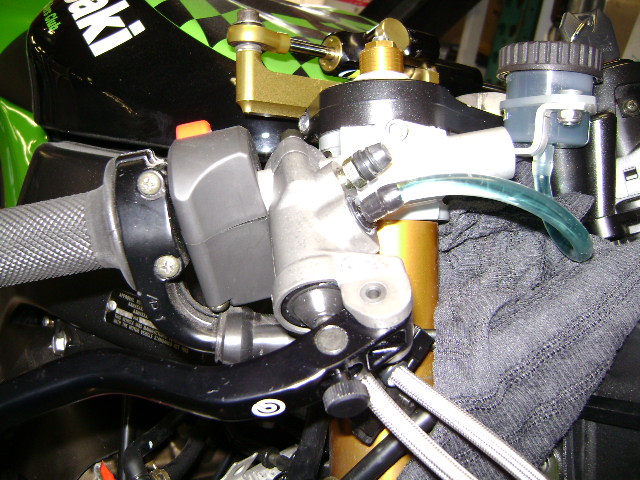

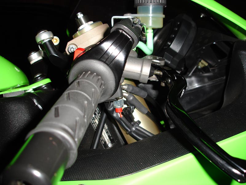

Well finally the Crim has better brakes :roll:
1 x Brembo Radial master cylinder 18 x 19 with the standard lever & new reseviour
All up the total cost was about $300 & luckily the already fitted braided lines positioned correctly without fuss :D
The only hitch was they supplied a single banjo instaed of the double I ordered & of corse they run a fine thread so none of my existing ones fitted :twisted: I managed to pick one up but it was a bit long so I had to shorten it before fitting which was no biggie ;) Upon fitting everything I discovered the joy of QUALITY PARTS! just the lever action alone far supasses the quality & feel of the OEM rubbish :roll:
I bled the lines then bled some more & then Presto I had what I was looking for no more spongy lever! THIS IS GREAT!
The Brembo MC also has an aditional bleed nipple at the top to extract every last air bubble.... farkin brilliant engineering!
Cant wait to test on the Track it should be awsome :D
Wattie we need to do some sort of comparson test between the Brembo MC & 14 calipers, Obviously both work better than OEM but I want to know how much better & which is the better option of the two

Dave the Problem I was having was the lever would pretty much come to the bar under hard braking (Brakes hot at the time) & the lever had next to no feel This was with new race pads, braided lines & copious bleeding sessions etc :cry:
The feel at the lever now with the brembo feels great, not squishy like the original set up.
No choice with the hose as the brembo runs a different size but its growing on me + you can see any bubbles :P

I have used this method for years & with the standard brakes new pads / braided lines it still did not help.... I went through 500ml for dot 5 fluid bleedidng them over & over & this was probably over 1 week including clamping the lever overnight in between but the result was shite!
I have clamped the lever with the brembo & that has made a bit more diference especially being able to bleed from the extra nipple at the top of the MC rather than crack the banjo's.
mate from the static difference the radial seems to be the go as the lever is now hard & not spongy... cant wait till the 9th to test em out :D
