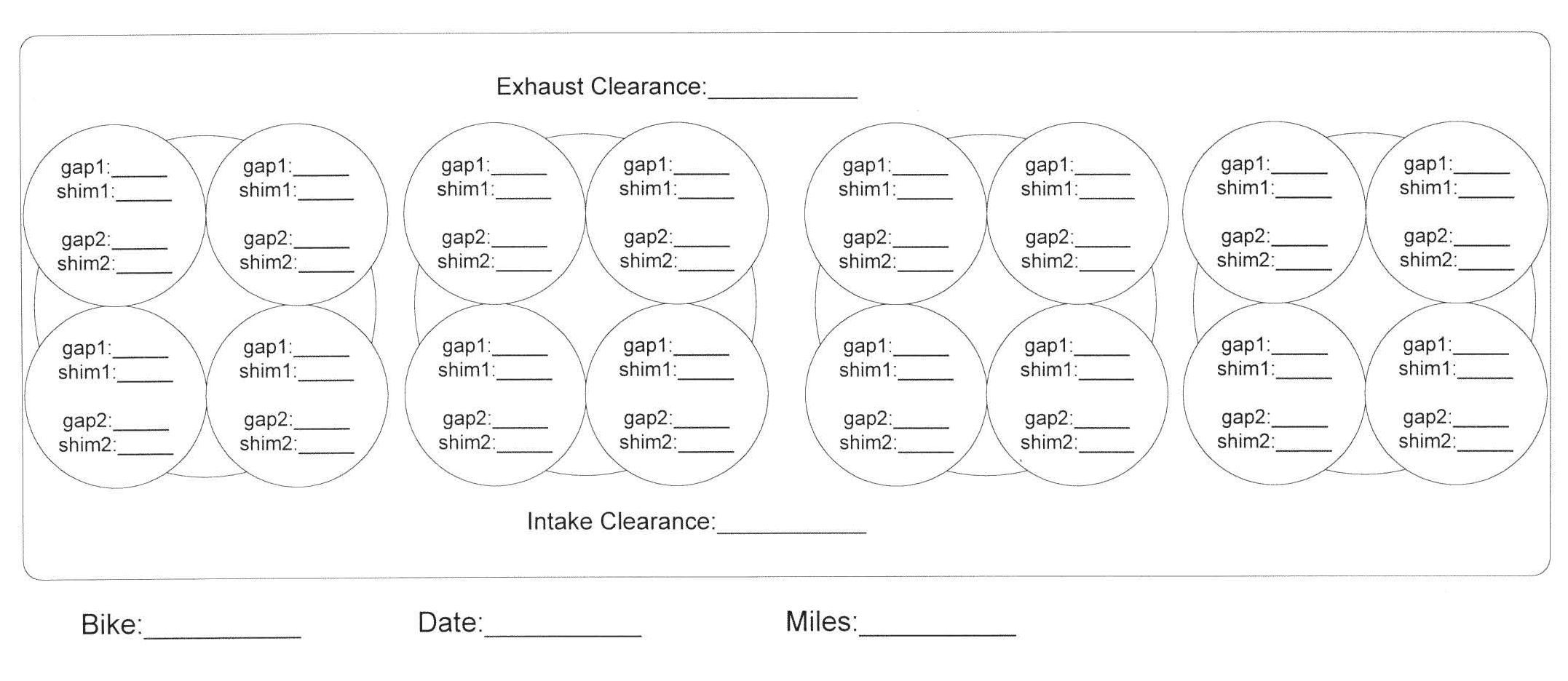

If you are going to get someone else to do it Mick, its a good idea to get your mechanic to make you up a valve map showing shim size in place and what clearance its got when the jobs done. Makes it easier to change/swap/replace next time as you know what size is where, new clearance measurements will let ya know what shims ya need to do the job as well (its not always the print on the reverse of the shims stays there) If you dont do them yourself, they will always come in handy for the mechanic next time round.
- Valve Map
- valveform.jpg (185.74 KiB) Viewed 5251 times
