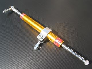

i bought a steering damper and went to fit it...but when i looked at what was supplied it didn't seem right. so i contacted the seller and he said it fits under the bottom yoke.....i can't see anywher to attatch it where it will work....i confused :? the pic is of everything that i got....any ideas????

Hey,
I could be wrong but I thought only the zx6rr had the frame mount for that style of mounting configuration. For the zx6r, with a damper like that you need a big ass mounting bracket that runs the damper parallel to the top toke in between the yoke and tank. I think harris, hyperpro and others would have mounts you could have a geez at on the net. Good luck.

Cwidova wrote:i bought a steering damper and went to fit it...but when i looked at what was supplied it didn't seem right. so i contacted the seller and he said it fits under the bottom yoke.....i can't see anywher to attatch it where it will work....i confused :? the pic is of everything that i got....any ideas????
That looks like one of the cheap POS dampers that a few eBay shops are selling .... universal, no fitting instructions included, etc, etc. Kinda like the Yoshimura rearsets on eBay ... they're thieves.
I'm not sure that you'll be able to use it (it may not be the correct length or stroke) but the idea is that you find somewhere you can attach one fitting (the one half-way along the damper body) to somewhere on the bike that doesn't move when you steer, and the other end to somewhere that does move when you steer (upper triple clamp, lower triple clamp or fork leg). You then need to ensure that the steering retains its full range of motion and that the rod through the damper doesn't foul upon anything anywhere in the range of motion.
Knowing how tight it is under the front of an '06 636 I won't be surprised if you don't find anywhere to fit it, but I may be surprised. Good luck.

thanks for the help....i think i might have found a place to mount it(top tank bolt & clutch or brake clamping)still yet to try it so i let you know how it all goes......failing that i might just have to fork out the cash and buy an ohlins one.....i know they fit my friend has one on the same bike :P

nah it all good now i gave up on that pos damper and got a ohlins one.....much less hassle and goes on properly!!! :D

Cool. Just out of interest, was the eBay one any good as a dampener - was the rod slow to move through the body, and did adjusting it make it easier and harder to move?

yeah it did everything it was supposed to.....it has 7 settings(not many compared to others)and it seemed to work pretty well.....i just couldn't mount it anywhere!!!!
