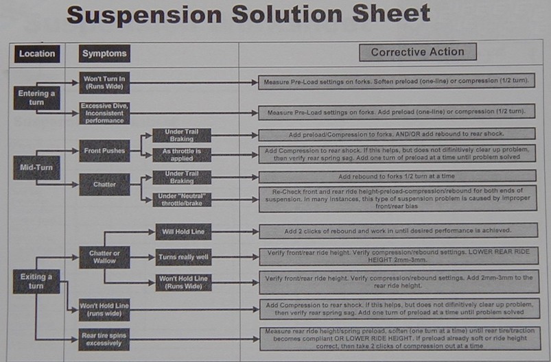

Re: 00 zx12r suspension
Suspension need adjusting.. Smitty remember that suspension chart you posted ?? Thats how i set up my 12 and got good results from it..
The 14 i knew what i was doing and just fiddled until i was happy.. As smitty says they are set for 68kg riders..
Here is the chart ..
- Suspensionsolutionsettings.jpg (110.47 KiB) Viewed 3968 times
aaah..yeah Paul
remember that !
thanks
'its an good 'un
trick is go back to base (or zero)
then start playing
buying a bike/getting a newie means you have NO
idea whats been fiddled with..go back to zero
and then start
remember that !
thanks
'its an good 'un
then start playing
and then start
thanks guys
i gave hoffys suggestion a go and it got rid of the head shake it turns quite good now but still dives excessively under brakes. i think thats more of a spring and oil problem though.
it also runs a little wide so ill use that chart.
thanks for the help
thanks for the help
