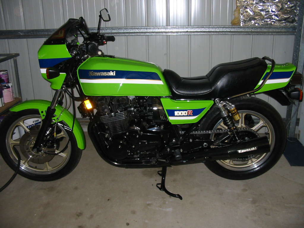

Very difficult to better ohlins, even my basic preload Ohlins shocks for my old eddie performed without fault for atleast 15years , and still continue on today,incredible craftmanship and well worth the initial pain in the hip pocket. Yep the standard suspension really does show it self on the zrx12 to be abit budget..but hey at $12999.00 plus onroads it's still the best bang for your buck out there. Maybe Iam just not tweeking it in the right places, only time and money will tell I guess...but it's a keeper and there's plenty of time to sort things out...touch wood.
I think once I can get a second hand seat out there to redo, cut down style of my old eddie, things will improve, take away that sitting on top and not into the bike. This proved to be the best mods on my zrx11 by far (apart from the akra) and seemed to shift weight where it should be. But it's proving to be very diffict to find one,as my wanted add has shown

- sea world.jpg (235.08 KiB) Viewed 4120 times

Nice looking bike the Z1000
