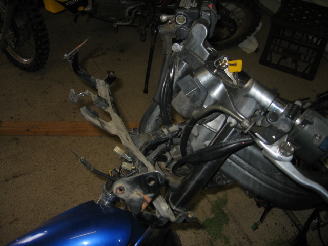

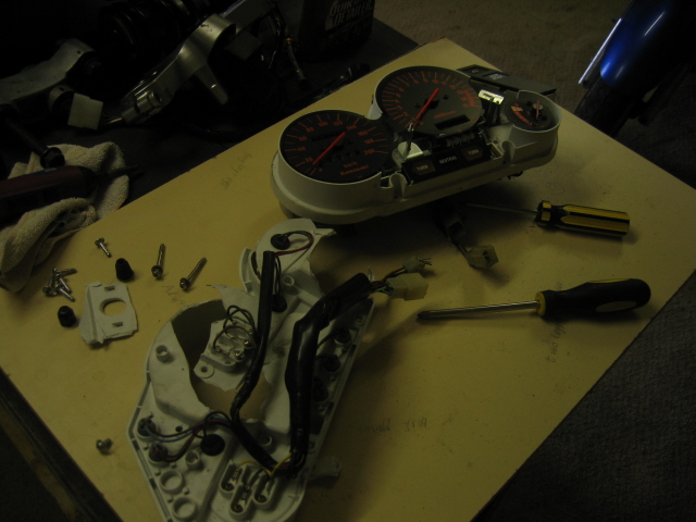

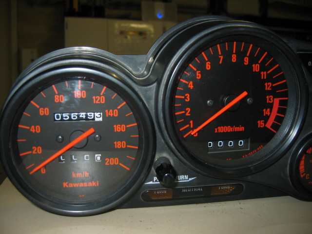

Here are some pics I took of the instrument upgrade:
Dismantling the gauges was fiddly the needles are hard to remove but can be prysed off with two screwdrivers.
I think the final result was worth the hour or so spent:

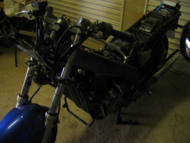

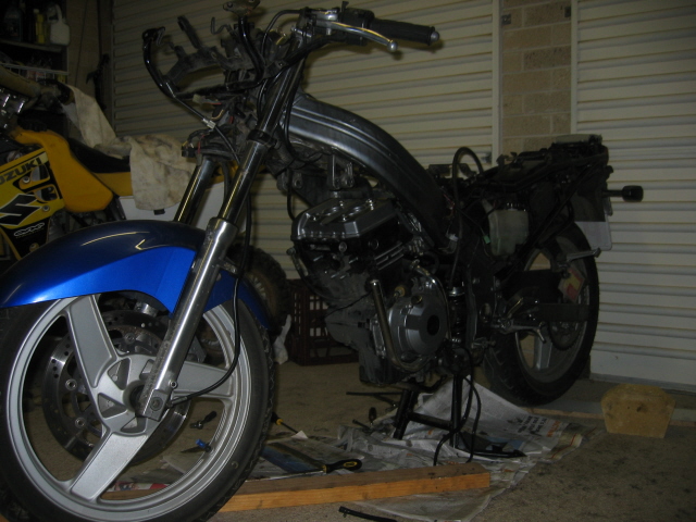

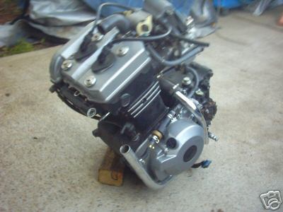

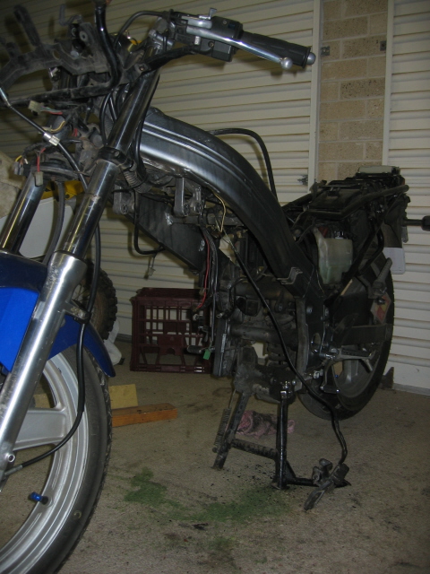

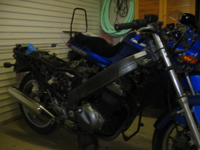

Here are the pictures I took during the engine transplant.

The whole job required no special tools and was not that difficult. I worked on the bike while it was on the big stand. A good 1/4 metric socket set and a few 1/2 drive metric sockets (12,14,17 and 19) and a couple of screwdrivers did most of the work.
To diassemble:
I took off the tank and seat and then all the fairings. i then removed the radiator and then the exhoust in one piece. I then removed the gauges and rebuilt ours using the new internals. I removed the motor and then the airbox, I think it can only come out through the front after the motor is out. I then had easy access to the rear shock once the motor and airbox were out. I split the airbox while it was out and gave the inside a good clean, the old motor must have been pressurizing the crankcase and blowing a bit of oil into the box through the breather pipe.
To assemble:
I put the airbox back in.
Put the new motor in. just hanging on the two back bolts.
Installed the exhaust.
Installed the radiator and front bracket.
Lifted the engine slightly and tightened all the bolts I locked the nuts with loctite 242.
At this stage I plumbed the radiator and connected the airbox to the carbies.
I reconnected the clutch, all wiring, throttle and choke cables. I put the instruments back in place.
I put on the tank and put the battery back in and was able to start the engine. The rest was just replacing the fairings, seat etc.
I bought the motor on Ebay for $500 it had done only 5,600 kms. I was able to get some other parts from the same bike when I picked the motor up.
I paid $50 for the instruments but they were pretty trashed, I used only the internals.
The rear shock I paid $100.
I also bought the top triple clamp for $50 as our ignition switch has been ruined by someone trying to start it with a screwdriver.
So for $700 total it was a pretty good update.
