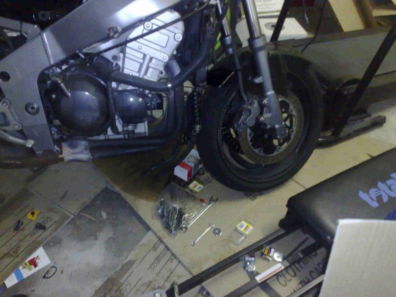

So I finally got some pics of the problem front end... Any ideas? I hope I put the pics on here lol
zx6r 2.jpg (60.86 KiB) Viewed 6335 times

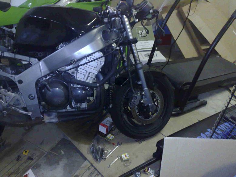

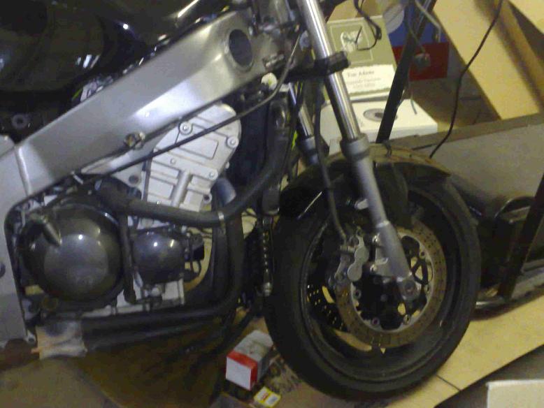

MickDee
Posts: 22
Joined: Mon May 05, 2008 7:05 pm
Location: Murray Bridge
Re: 1995 ZX6R questions
Post by MickDee »
another image may help
zx6r 3.jpg (56.84 KiB) Viewed 6322 times

It might just be the photos, but those forks don't look like they've got anywhere near enough rake. Has this bike been crashed Mick? It really looks to me a lot like the second photo Mitch posted - the one that's run up the arse of a car.

yeah, it had an off at about 40 km's an hour on the grass. It has hardly any crash damage apart from the radiator and oil cooler.
Sulli
Posts: 1096
Location: Brisbane/southside
Post by Sulli »
The frame is bent :cry: up near the steering head there are some creases.
If you look at mitches first pic of the straight bike and then look at yours. :(
