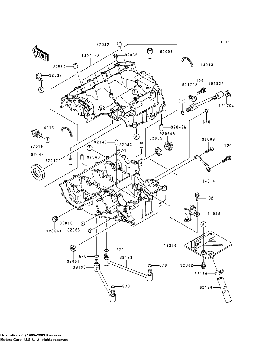

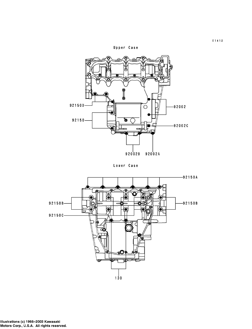

Sulli
Posts: 1096
Location: Brisbane/southside
Re: 98 zx6r splitting the crankcase
Post by Sulli »
these may help
chikin
Posts: 42
Joined: Thu Dec 09, 2004 7:37 pm
Location: Southside Brisbane
Post by chikin »
many thanks! :D

Hrm I don't think we've taken out 40 bolts...
will have to have a closer inspection of these diagrams :)

Theres closer to 50 bolts if you include the sump which I assume you have taken off :shock: to get to the main journal bolts :)
chikin
Posts: 42
Post by chikin »
Oh right... the manual never mentioned anything about that :/ I wish someone had of said that earlier :(
