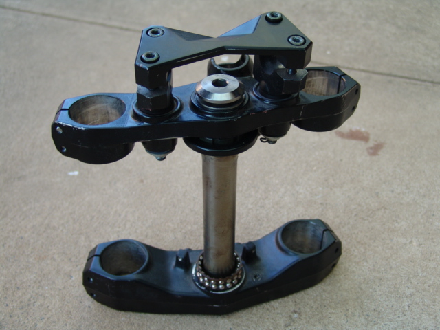

Does the ignition barrel just slide out?
Not just yet, thanks Tanya!
Muzzy Ti 4 into 1, Power Commander III USB, K&N, Airbox mod, KLEEN delete, Throttle quickener, Vortex -1 front sprocket, Renthal Ultra Low 'bars, Seat cowl, Ohlins 0.95kg fork springs, ZX6R shock. 130hp/ 70ft/lbs!
- robracer
- Posts: 15251
- Location: Port Macquarie
Re: Top Yoke Removal - Help
Yes it does, here is a pic of the 05 set I picked up for my front end conversion showing the hole for the barrel:deafwish wrote:Does the ignition barrel just slide out?
- DSC05676.JPG (137.56 KiB) Viewed 3416 times
