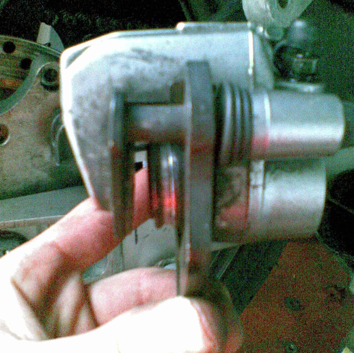

hey guys,
I own a zxr250 and i took of the brake caliper to chnage the pads, but my disc is far to damaged so i have to replace that to. i took of the caliper and took of the pads but i sort of got the piston closed, i opened up whatever i could, but i cant get the old pads back in let alone the new ones.
I snapped 2 G clamps trying to push it back in. i had the brake fliud cap opened so it can pushed back in easier but it wont budge.
any ideas on how i can push it bakc in to put my new pads in?
(sorry bout pic quality, took it with my phone) :?
i put 2 pictures in, one is with one pad and the gap between the pad and the piston,

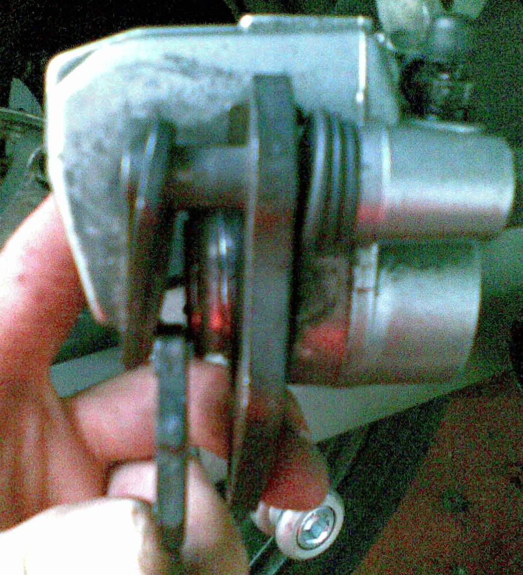

the 2nd photo is with both pads trying to put them together.

Not sure exactly what you have done but that piston does not look square at all. Remove the caliper from the bike.Remove the brake line from the caliper and see if you can square it up by pushing against the top of the piston. I would suspect new seals and a total rebuild might be in order though.

I just did the padds on my ZX-12r. I did notice there seems to be a spacer between the piston and the back of the brake pad. I "disturbed mine and it wasn't sitting square when I went to put the pads back in. It doesn't take much dust/crap for the spacer not to sit square.As suggested take the caliper off and invesigate, however I wouldn't disconnect the brake line just yet. BTW where are you?

The piston must be square in the caliper...... by the looks of the angle it is going in you are in trouble & fingers crossed you have not damaged the sides of the bore :shock: Take the caliper off & use compressed air to carefully push out the piston & make sure you catch it when it pops off :shock: & look for damage before proceeding to push the piston back in square..... hint polish the piston on a buffing wheel to remove any scale that you might have on the surface & you should replace the seals while you are at it as they are an inexpensive part & should be replaced periodically ... use a little high temp grease on the seal before you pop the piston back in ;) as asked before where are you located ?

Rubber grease , lanoteck grease or at worst petroleum jelly on caliper piston seals ONLY or you stand a good chance of FARKING the seal and contaminating the brake fluid meaning next job will be master cylinder!!
Fadz you NEVER need that much force on brake calipers , particularly if it was previously working![broke two G clamps???????]
You badly cocked the piston over and have probably now scored the bore with excessive brutality!! Two screw drivers while the old pads are still fitted is more than enough force if the piston is aligned properly!!
Slip you old pads back in or even a piece of flat bar / wood etc with the caliper removed as it is now. GENTLY apply the brakes until the piston frees itself and squares up. Then GENTLY push the piston back making sure you apply EVEN pressure .If it jams , find the high side and push there rather than using BRUTE FORCE AND IGNORANCE!!!
once you push the piston all the way home so it is flush with the caliper body / dust seal you can then fit your new pads and re fit the caliper.
Make sure you pump the brake lever till it gets hard and top up your fluid BEFORE you go for a test ride!!
Hopefully you haven't farked it dude!?

i pushed it all the way before it stuffed up without a breeze, and as it closed back up beacuase i closed it back up, it was the biggest mission to open it.
yes i broke 2 g clamps not big ones , one was a 100mm the other a 75mm or 85 mm, i tried to bleed it abit so it can compress back in but still didnt work, its out of square becuase i couldn't fit the whole g clamp over it, i had to do it from side to side. if that amkes sense?
