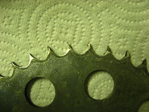

When she looks like this she's knackered :shock:
Worn fecker.jpg (123.49 KiB) Viewed 3489 times
I only use RK chains & sprockets are a mixed bag... as for frequency of change I generally change as a set when wear is showing on the rear sprocket

robracer wrote:When she looks like this she's knackered :shock:
Hey Rob, Got ya moneys worth outa that one didnt ya :lol:
Re: how often should chains and sprockets be changed?
Not my sproget :lol: googled that one ;)
fadz90 wrote: i've been advised if i change the chain and use the old sprockets it will eat the chain and a new sprocket to a old chain it will eat the sprockets away
Dont know about eat, but yes you should replace as a set ;) & front sprockets are cheap as. MAW at castle hill have a good stock of sprockets & chains if they ever re open :roll: freekin big arse crane landed on their building :shock: :shock: :shock:

robracer wrote:Not my sproget :lol: googled that one ;)
HAHAHAHAHAHAHAHAHAHA, that crane fell over lifting my concrete :lol: :lol: :lol: :lol:

Change your sprockets and chain when:
- your rear sprocket has sharp points
- your chain is loose, and you can't adjust it tighter
- your chain has tight spots that mean it can't be adjusted right
and yes - change your chain and sprockets together otherwise the old will wear out the new.
