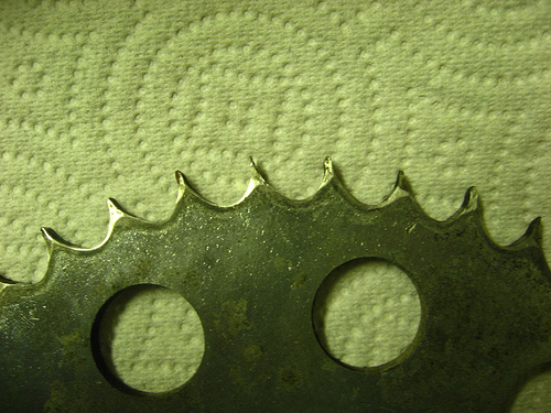

When she looks like this she's knackered :shock:
Worn fecker.jpg (123.49 KiB) Viewed 3511 times
I only use RK chains & sprockets are a mixed bag... as for frequency of change I generally change as a set when wear is showing on the rear sprocket

robracer wrote:When she looks like this she's knackered :shock:
Hey Rob, Got ya moneys worth outa that one didnt ya :lol:

by robracer
Not my sproget :lol: googled that one ;)
fadz90 wrote: i've been advised if i change the chain and use the old sprockets it will eat the chain and a new sprocket to a old chain it will eat the sprockets away
Dont know about eat, but yes you should replace as a set ;) & front sprockets are cheap as. MAW at castle hill have a good stock of sprockets & chains if they ever re open :roll: freekin big arse crane landed on their building :shock: :shock: :shock:
