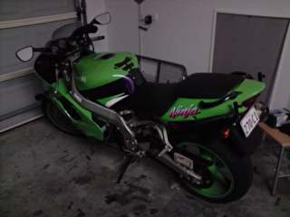

My new toy
My new toy

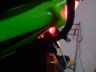

My little brake light mod
