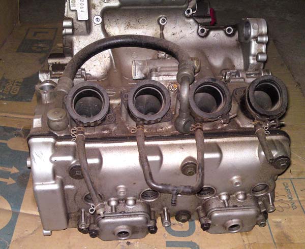

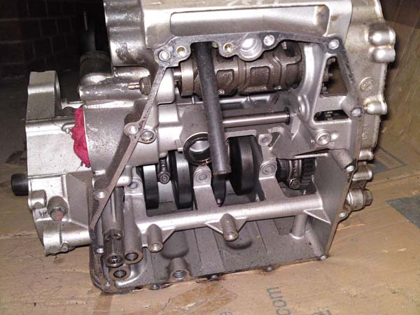

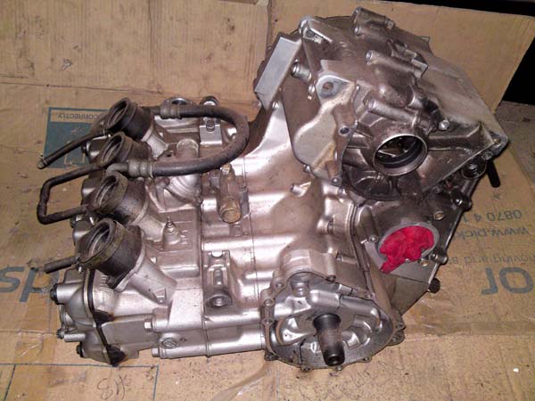

Re: Big-end Bearing Replacement
I have a top end sitting waiting for someone to buy it, was the one Dan got to rebuild his gearbox before he moved to Tassie. So gearbox cases are split, but crankshaft and top end are whole. Not sure how much Dan wants for it, but it's an option.
I just got a message from Dan, he does not know the condition of this engine. He never turned it over, but simple used gearbox parts for his bike. The price is very good though...
