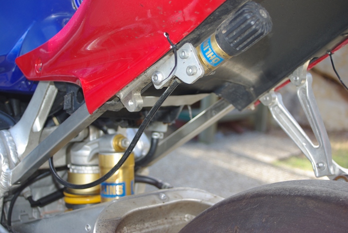

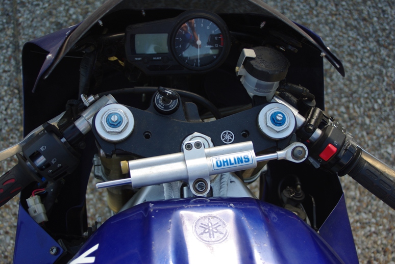

I'm just getting the R1 ready for its first track day (Aust Day at QR - anyone else going?) and have a couple of questions.
Both the steering damper and rear shock are fully adjustable, but as I haven't ridden it yet I don't at what position they are currently set. Can I wind them both to the end of their adjustment and then go to the middle or are they infinitely adjustable or should I just take the steering damper off? (ie; never find the end of their adjustment). Pictures of them are below, (yes I know the steering damper is not bolted on, I was in the process of putting the tank on).
Those eagle eyed of you will notice the different colouring of the R1, it now has blue upper fairing and tank and black lower fairing and mudguard, with the same red seat cowl. It will be painted in due course, but I picked all that up for $750 with good delivery cost via Pack & Send.

You really don't need the hassle of that big fancy Ohlins ---- $50.00 posted and i'll send back a far more user friendly unit with a simple 5 position spring preload adjustment aka GSF1200. Easy :lol: :lol: :lol: :lol:
