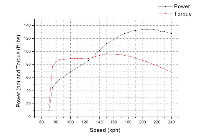

Well just for shits and giggles I did a calculation from power to torque and this is what I got.
dyno calc torque.JPG (124.49 KiB) Viewed 7071 times
A peak torque of 96 ft.lbs :shock: Somehow I don't think this is realistic :roll: , even though this is the same method used to calculate the actual torque graphs. Be interesting to compare this to the measured one next week.
