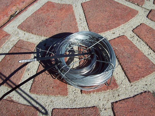

Bunnings have plenty of wire...
pic below shows bunnings wire .9mm thick (gal) and m/c shop lock wire .7mm thick (s/s)...
The proper M/C shop wire is better, it can be twisted and bent more before breaking and will last longer..
