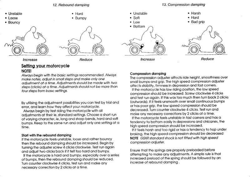

The first step to a good setup is setting static sag. For street purposes, front sag should generally be between 30 and 35mm, and rear sag between 25 and 30mm. Don't vary from these numbers if you're heavier or lighter--that's the whole idea of measuring sag while you are on the bike. An easy way to check if your shock spring rate is in the ballpark is to measure the rear "free" sag, that is, the sag without your weight on the bike. This number should be between 0 and 5mm--with the bike off its stand and on its own, you should be able to lift the rear end just slightly and top out the suspension. If your bike is topped out at rest, you need a stiffer spring, because you have got a lot of preload dialed in to achieve the correct static sag. Alternately, if your bike has a lot of free sag (you can lift the rear a bunch before it tops out), you need a softer spring.
Rebound damping can be initially set as follows: With the sag properly set and the bike at rest and off its stand, firmly push on the triple clamp (don't hold on the brake or push the handlebar) or seat. When you let go, the suspension should rebound quickly to its original position--but not beyond. If it takes more than approximately one second for the suspension to return to position, less rebound damping is needed. If the fork or shock over-extends past its free sag, and then compresses again, more rebound damping is required. Street riding entails many different pavement characteristics, and the road is generally bumpy compared to a racetrack, so it's better to err on the soft side if you are unsure. This will also give you the added benefit of a smooth ride for daily use; you can always dial in a tad more rebound when you get to your favourite road where the surface is more of a known quantity.
Compression damping can be initially set as follows: It is difficult to set compression damping without riding your motorcycle and feeling how its suspension works. What feels nice and plush at a standstill may turn out to be too harsh at speed, and compression damping is sometimes set by personal preference as opposed to a definite optimum. Start with the compression adjusters in the middle of their adjustment range, and take your bike for a spin. Working with the front and rear individually, soften the damping adjuster, and try your bike again over the same road. Is your handling better? Worse? The same? Try again, this time with the damping stiffer than what you started with. Continue experimenting, making adjustments accordingly. As with rebound damping, it's always best to err on the light side with compression, and for the same reasons.

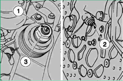

On most forks,
Rebound Damping (1) - the screw adjustment at the top is rebound damping (not to be confused with the larger spring preload adjuster)
Preload adjuster (3)- Is the larger nut on the top of the front forks (not to be confused with the smaller rebound damping). Movement of the Forks within the Triple Clamps, can be substituted for the preload adjuster.
Compression Damping (2) - the one on the bottom near the axle is compression damping.

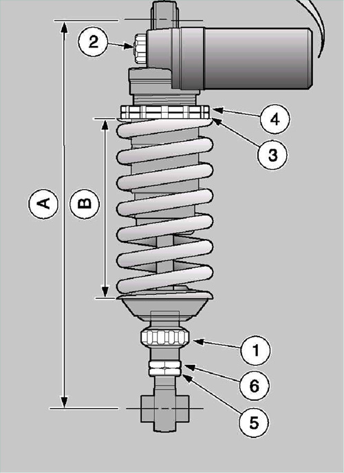

Rear Shock
Preload adjuster (3&4) - Is adjusted by using a C-Spanner or the appropriate wrench/spanner.
Compression Damping (2) - is the adjuster on the reservoir usually a knob or a screw.
Rebound Damping (1) is the adjuster knob on the shaft .
rear adjust.jpg (67.34 KiB) Viewed 90358 times
rear adjust screws1.jpg (36.59 KiB) Viewed 90359 times
On late model shocks it can be located down below the dial #1 near the lower pin but not always.
What is becoming more common these days is low and high speed adjusters for dampning, so this diagram is out of date in this case...
Spring Preload - Release the ring nut (4) by means of the appropriate spanner. Adjust (B) through the adjusting ring nut (3) After adjusting, tighten the ring nut (4).
Rebound Damping - Work the ring nut (1) to set shock absorber rebound damping.
Compression Damping - Adjustments are made by turning the knob or, by turning the screw (2) depending on types of models.
Rear Ride Height Adjustment, proceed as follows:
Slightly loosen the lock nut (5) .
Turn the adjuster (6) to change the overall length of the rear suspension shock absorber length (A) (distance between centers).
Hold the adjuster (6) with the appropriate wrench and tighten the lock nut (5) (aprilia 40Nm)

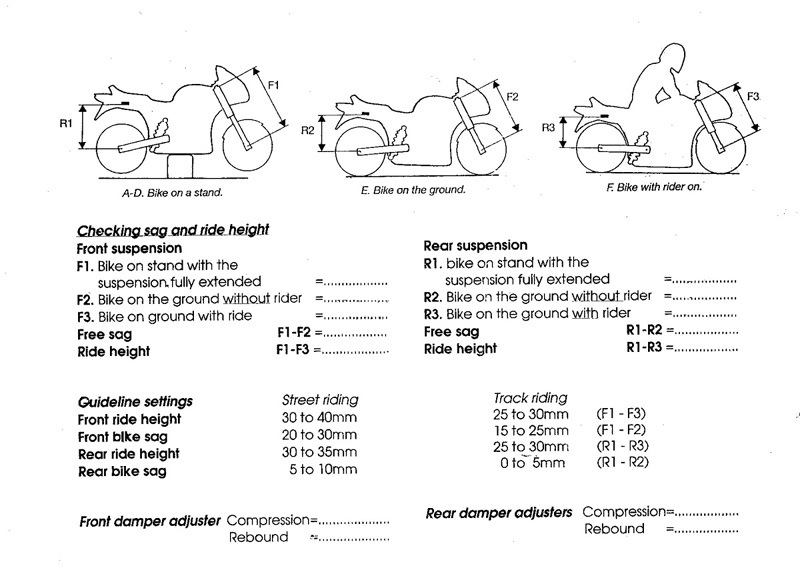

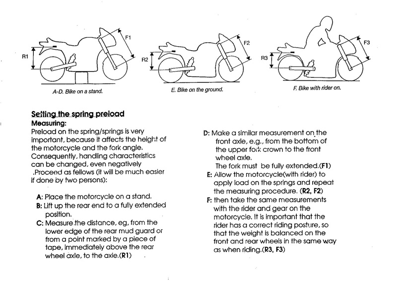

SETTING STATIC SAG
No matter what shock or fork you have, they all require proper adjustment to work to their maximum potential. Suspension tuning isn't rocket science, and if you follow step-by-step procedures you can make remarkable improvements in your bike's handling characteristics.
The first step to setting up any bike is to set the spring sag and determine if you have the correct-rate springs. Spring sag is the amount the springs compress between fully topped out and fully loaded with the rider on board in riding position. It is also referred to as static ride height or static sag.
If you've ever measured sag before, you may have noticed that if you check it three or four times, you can get three or four times, you can get three or four different numbers without changed anything. We'll tell you why this occurs and how to handle it.
REAR END SAG
Step 1: Extend the suspension completely and measure. By getting the wheel off the ground. It helps to have a few friends around. On bikes with side stands the bike can usually be carefully rocked up on the stand to unload the suspension. Most race stands will not work because the suspension will still be loaded by resting on the swing arm rather than the wheel. Measure the distance from the axle vertically to some point on the chassis (metric figures are easiest and more precise; Mark this reference point because you'll need to refer to it again. This measurement is L1. If the measurement is not exactly vertical the sag numbers will be inaccurate (too low).
What you are going to do is get the average of the compression with a rider on the bike from two different directions
Step 2: Downward Compression suspension with Rider on the bike and measure. Take the bike off the stand and put the rider on board in riding position. Have a third person balance the bike from the front. If accuracy is important to you, you must take friction of the linkage into account. This is where our procedure is different: We take two additional measurements. First, push down on the rear end about 25mm (1") and let it extend very slowly.
Where it stops, measure the distance between the axle and the mark on chassis again. If there were no drag in the linkage the bike would come up a little further. It's important that you do not bounce! This measurement is L2.
Step 3: Upward Compression of suspension with Rider on the bike and measure. Have your assistant lift up on the rear of the bike about 25mm and let it down very slowly. Where it stops, measure it. If there were no drag it would drop a little further. Remember, don't bounce! This measurement it L3.
Step 4: Do the number crunch: The spring sag is in the middle of these two measurements. In fact, if there were no drag in the linkage, L2 and L3 would be the same. To get the actual sag figure you find the midpoint by averaging the two numbers and subtracting them from the fully extended measurement L1: static spring sag = L1 -[(L2 + L3) / 2].
Step 5: Adjust the preload with whatever method applies to your bike. Spring collars are common, and some benefit from the use of special tools. In a pinch you can use a blunt chisel to unlock the collars and turn the main adjusting collar. If you have too much sag you need more preload; if you have too little sag you need less preload. For road race bikes, rear sag is typically 25 to 30mm. Street riders usually use 30 to 35mm. Bikes set up for the track are compromise when ridden on the street. The firmer settings commonly used on the tract are generally not recommended (or desirable) for road work.
Measuring front-end sag is very similar to the rear. However, it' much more critical to take seal drag into account on the front end because it is more pronounced.
FRONT END SAG
Step 1: Extend the suspension completely and measure. Extend the fork completely by getting the bike off the ground and measure from the wiper (the dust seal atop the slider) to the bottom of the triple clamp (or lower fork casting on inverted forks; Figure 2). This measurement is L1.
Step 2: Downward Compression suspension with Rider on the bike and measure. Take the bike off the side stand, and put the rider on board in riding position. Get and assistant to balance the bike from the rear, then push down on the front end and let it extend very slowly.
Where it stops, measure the distance between the wiper and the bottom of the triple clamp again. Do not bounce. This measurement is L2.
Step 3: Upward Compression of suspension with Rider on the bike and measure. Lift up on the front end and let it drop very slowly. Where it stops, measure again. Don't bounce. This measurement is L3. Once again, L2 and L3 are different due to stiction or drag in the seals and bushings, which is particularly high for telescopic front ends.
Step 4: Do the number crunch: Just as with the front, halfway between L2 and L3 is where the sag would be with no drag or stiction. Therefore L2 and L3 must be averaged and subtracted from L1 to calculate true spring sag: static spring sag = L1 - [l2 + l3) / 2].
Step 5: Adjust the preload. To adjust sag use the preload adjusters, if available, or vary the length of the preload spaces inside the fork.
Street bikes run between 25 and 33 percent of their total travel, which equates to 30 to 35mm. Roadrace bikes usually run between 25 and 30mm.
This method of checking sag and taking stiction into account also allows you to check the drag of the linkage and seals. It follows that the greater the difference between the measurements (pushing down and pulling up), the worse the stiction. A good linkage (rear sag) has less than 3mm (0.12") difference, and a bad one has more than 10mm (0.39"). Good forks have less than 15mm difference, and we've seen forks with more than 50mm. (Gee, I wonder why they're harsh?)
It's important to stress that there is no magic number. If you like the feel of the bike with less or more sag than these guidelines, great. Your personal sag and front-to-rear sag bias will depend on chassis geometry, track or road conditions, tyre selection and rider weight and riding preference.
Using different sag front and rear will have huge effect on steering characteristics. More sag on the front or less sag on the rear will make the bike turn more slowly. Increasing sag will also decrease bottoming resistance, though spring rate has a bigger effect than sag. Racers often use less sag to keep the bike clearance, and since roadraces work greater than we see on the street, they require a stiffer setup. Of course, setting spring sag is only first step of dialing in your suspension, so stay tuned for future articles on spring rates and damping.
Typical setup for Sag
Bike Type Front % Front mm Rear % Rear mm Rear Free Sag mm
Street Bikes 28-33% 30-35mm 28-33% 30-35mm 0-5mm
Road Race Bikes 23-27% 25-30mm 23-27% 25-30mm 0-5mm

SUSPENSION DAMPING SYMPTOMS
Here are some basic symptoms of suspension damping problems that you might find affecting your bike. Remember these are extreme examples; your symptoms may be more subtle. You may also have to find an acceptable compromise on either end of the adjustment spectrum. It all depends on how the bike's handling "feels" to you.
Front Fork
LACK OF REBOUND DAMPING (FORK)
The fork offers a supremely plush ride, especially when riding straight up. When the pace picks up, however, the feeling of control is lost. The fork feels mushy, and traction "feel" is poor. After hitting bumps at speed, the front tyre tends to chatter or bounce. When flicking the bike into a corner at speed, the front tyre begins to chatter and lose traction. This translates into an unstable feel at the clip-ons. As speed increases and steering inputs become more aggressive, a lack of control begins to appear. Chassis attitude and pitch become a real problem, with the front end refusing to stabilize after the bike is counter steered hard into a turn.
- Understeer!
- The front can feel unstable.
Symptoms:
Forks are plush, but increasing speed causes loss of control and traction
The motorcycle wallows and tends to run wide exiting the turn causing fading traction and loss of control.
When taking a corner a speed, you experience front-end chatter, loss of traction and control.
Aggressive input at speed lessons control and chassis attitude suffers.
Front end fails to recover after aggressive input over bumpy surfaces.
Solution:
Insufficient rebound. Increase rebound "gradually" until control and traction are optimized and chatter is gone.
TOO MUCH REBOUND DAMPING (FORK)
The ride is quite harsh--just the opposite of the plush feel of too little rebound. Rough pavement makes the fork feel as if it's locking up with stiction and harshness. Under hard acceleration exiting bumpy corners, the front end feels like it wants to "wiggle" or "tankslap." The tyre feels as if it isn't staying in contact with the pavement when on the gas. The harsh, unforgiving ride makes the bike hard to control when riding through dips and rolling bumps at speed. The suspension's reluctance to maintain tyre traction through these sections erodes rider confidence.
- Oversteering!
- It will give poor grip of the front tyre.
- It feels like the front wheels will tuck under in corners.
Symptoms:
Front-end dives severely, sometimes bottoming out over heavy bumps or during aggressive breaking.
Front feels soft or vague similar to lack of rebound.
When bottoming, a clunk is heard. This is due to reaching the bottom of fork travel.
Solution:
Insufficient compression. Increase "gradually" until control and traction are optimized.
LACK OF COMPRESSION DAMPING (FORK)
Front end dive while on the brakes becomes excessive. The rear end of the motorcycle wants to "come around" when using the front brakes aggressively. The front suspension "bottoms out" with a solid hit under heavy braking and after hitting bumps. The front end has a mushy and semi-vague feeling--similar to lack of rebound damping.
- Strong diving of the front.
Adjustment advice: Compression damping should be adjusted together with front fork oil level.
Symptoms:
Solution:
TOO MUCH COMPRESSION DAMPING (FORK)
The ride is overly harsh, especially at the point when bumps and ripples are contacted by the front wheel. Bumps and ripples are felt directly; the initial "hit" is routed through the chassis instantly, with big bumps bouncing the tyre off the pavement. The bike's ride height is effected negatively--the front end winds up riding too high in the corners. Brake dive is reduced drastically, though the chassis is upset significantly by bumps encountered during braking.
- Good result during braking.
- Feels harsh over the bumps.
Symptom:
Front end rides high through the corners, causing the bike to steer wide. It should maintain the pre-determined sag, which will allow the steering geometry to remain constant.
Solution:
Decrease compression "gradually" until bike neither bottoms or rides high.
Symptom:
Front end chatters or shakes entering turns. This is due to incorrect oil height and/or too much low speed compression damping.
Solution:
First, verify that oil height is correct. If correct, then decrease compression "gradually" until chattering and shaking ceases.
Symptom:
Bumps and ripples are felt directly in the triple clamps and through the chassis. This causes the front wheel to bounce over bumps.
Solution:
Decrease compression "gradually" until control is regained.
Symptom:
Ride is generally hard, and gets even harder when braking or entering turns.
Solution:
REAR SHOCK
LACK OF REBOUND DAMPING (REAR SHOCK)
The ride is plush at cruising speeds, but as the pace increases, the chassis begins to wallow and weave through bumpy corners. This causes poor traction over bumps under hard acceleration; the rear tyre starts to chatter due to a lack of wheel control. There is excessive chassis pitch through large bumps and dips at speed and the rear end rebounds too quickly, upsetting the chassis with a pogo-stick action.
- The rear "tops out" too fast under braking, causing the rear wheel to jump
- The bike feels unstable.
Symptoms:
The ride will feel soft or vague and as speed increases, the rear end will want to wallow and/or weave over bumpy surfaces and traction suffers.
Loss of traction will cause rear end to pogo or chatter due to shock returning too fast on exiting a corner.
Solution:
Insufficient rebound: Increase rebound until wallowing and weaving disappears and control and traction are optimized.
TOO MUCH REBOUND DAMPING (REAR SHOCK)
This creates an uneven ride. The rear suspension compliance is poor and the "feel" is vague. Traction is poor over bumps during hard acceleration (due to lack of suspension compliance). The bike wants to run wide in corners since the rear end is "packing down"; this forces a nose-high chassis attitude, which slows down steering. The rear end wants to hop and skip when the throttle is chopped during aggressive corner entries.
- The rear "jumps" on the bumps instead of following the surface.
- The rear "jitters" under braking.
- It holds the rear down with the result that the bike will understeer!
- It can cause overheating in the hydraulic system of the shock
absorber and make it fade, in other words, it will loose damping
when hot
Symptoms:
Ride is harsh, suspension control is limited and traction is lost.
Rear end will pack in, forcing the bike wide in corners, due to rear squat. It will slow steering because front end is riding high.
When rear end packs in, tyres generally will overheat and will skip over bumps.
When chopping throttle, rear end will tend to skip or hop on entries.
Solution:
Too much rebound. Decrease rebound "gradually" until harsh ride is gone and traction is regained. Decrease rebound to keep rear end from packing.
LACK OF COMPRESSION DAMPING (REAR SHOCK)
There is too much rear end "squat" under acceleration; the bike wants to steer wide exiting corners (since the chassis is riding rear low/nose high). Hitting bumps at speed causes the rear to bottom out, which upsets the chassis. The chassis attitude is affected too much by large dips and G-outs. Steering and control become difficult due to excessive suspension movement
- The rear wheel start to bump sideways under acceleration out of the corner.
- The bike will squad too much (rear is too low), that will cause the front to loose grip..
Symptoms:
The bike will not turn in entering a turn.
With bottoming, control and traction are lost.
With excessive rear end squat, when accelerating out of corners, the bike will tend to steer wide.
Solution:
Insufficient compression. Increase compression "gradually until traction and control is optimized and/or excessive rear end squat is gone.
TOO MUCH COMPRESSION DAMPING (REAR SHOCK)
The ride is harsh, though not quite as bad as too much rebound; the faster you go, the worse it gets, however. Harshness hurts rear tyre traction over bumps, especially during deceleration. There's little rear end "squat" under acceleration. Medium to large bumps are felt directly through the chassis; when hit at speed, the rear end kicks up.
- The rear wheel to slide under acceleration .
- It can give a harsh ride over bumps.
Symptoms:
Ride is harsh, but not as bad as too much rebound. As speed increases, so does harshness.
There is very little rear end squat. This will cause loss of traction/sliding. Tyre will overheat.
Rear end will want to kick when going over medium to large bumps.
Solution:
Decrease compression until harshness is gone. Decrease compression until sliding stops and traction is regained.
Spring ratio
Rear
Too hard spring ratio:
- Gives easy turning into corners.
- Makes the rear feel harsh.
- Create poor rear wheel traction.
Too soft spring ratio:
- Gives good traction in acceleration.
- Creates understeer in entry of corner.
- Makes too much suspension travel which will make it difficult to "flick" the bike from one side to the other in a chicane.
- Will give a light feeling in the front.
Front
- Good under braking.
- Creates understeer.
- It feels harsh in the corners.
- Creates oversteer.
- Can cause front to tuck under.
- Bad under braking (diving).
Front fork oil level
First see manual. The modern front fork of cartridge type is very sensitive for oil Level changes, because of the small air volume Air inside the front fork works as a spring. The different level of oil effects the spring ratio from the middle of the stroke and has a very strong effect at the end of the stroke.
When the oil level is raised: The air spring in the later half stage of travel is stronger, and thus the front forks harder.
When the oil level is lowered: The air spring in the later half stage of travel is lessened, and thus the front forks are softer. The oil level works most effectively at the end of the fork travel.

Fork Adjustments,Settings and Effect
Fork Oil Level
Oil level too low Forks bottom out during hard braking or large bumps
Oil level too high Front wheel skips on bumps
Compression Damping
Too much:
Bike difficult to turn in and will steer wide through the turn
Forks judder when braking in a straight
Front end feels harsh on small bumps
Not enough
Forks dive too quickly, possibly bottoming out
Rear end wants to come around during hard braking
Front end has a mushy and semi-vague feeling, similar to lack of rebound damping
Rebound Damping
Too much
Front end chatters coming out of corners
Forks pack down on fast bumpy pavement
Front end wiggles or tank-slaps on hard acceleration out of bumpy corners
Harsh ride due to forks packing down
Not enough
Excessive pogo action through chicanes
Front end shakes (not chatters) in corners
Front end shoots up too fast after braking
Feels plush when riding straight, but mushy in corners and traction feel is poor
When flicking into a corner at speed, the bike will porpoise or wallow a bit before settling down
Ride Height
Too low
Lack of high speed stability
Easy turn-in into corners
Too high
Sluggish or high effort turn-in into corners
Spring Rate
Too soft
Forks compress too much on smooth turns
Creates oversteer
Turns easily into corners
Too stiff Creates understeer
Lose front end on corner entry
Harsh in corners
Feels good under braking
Rear Shock
Compression Damping
Too much
Shock rigid and harsh, but not as bad as too much rebound damping
Rear wheel skips when braking on rippled pavement
Very little rear end squat on acceleration
Not enough
Shock bottoms out on medium sized bumps
Rear end squats on acceleration
Possible bottoming of shock
Bike steers wide exiting corners (rear-low, nose-high)
Rebound Damping Too much Rear wheel hops on turns with small bumps, especially washboard
Rear end packs down over series of bumps
Rear feels harsh
Not enough
Too much kicking up when braking hard
Bike wallows when exiting corners or in long rolling dips in sweepers
Rear wheel chatters under hard acceleration over bumps
Too much chassis pitch/pogo stick action
Ride Height
Too low
Motorcycle understeers on exit corners
Difficult to change direction
Poor grip from front tyre on exit corners
Too high
Poor grip from rear tyre
Unstable under heavy braking
Spring Rate
Too soft
Ride is soft
"Light" feeling on the front
Too stiff
Easy turn-in to corners
Ride is harsh
Poor rear wheel traction

Free Sag--the amount the bike settles under its own weight. Both streetbikes and race bikes require 0 to 5mm of free sag on the rear. The bike should not top out hard.
Packing--a phenomenon caused by excessive rebound damping. When a series of bumps, such as ripples, are encountered the suspension does not rebound completely between bumps and compresses (packs) further down on each successive bump. This can drastically change steering geometry if packing occurs on only one end of the motorcycle.
Preload--the distance a spring is compressed from its free length as it's installed with the suspension fully extended. Preload Adjuster--a method of adjusting suspension components' preload externally. These can be ramped or threaded.
Preload Spacer--material used to adjust a fork's preload internally. Typically, thin-walled aluminum or PVC tubing is used.
Rake--the steering neck angle (not the fork angle) relative to vertical, which varies with changes in ride height. For example, the rake angle decreases when the front end compresses or is lowered. Changes in tyre diameter can also influence rake by altering the ride height.
Ride Height--suspension adjustments (raising or lowering the fork or lengthening or shortening the shock) to alter the chassis attitude of the motorcycle.
Shock preload can be altered with a spanner wrench or with the time honored hammer and punch.
Sag--the amount the front or rear of the bike compresses between fully topped out and fully loaded with a rider (and all of his riding gear) on board in the riding position. Sag can also affect steering geometry. Extra sag on the front end will decrease the effective steering head angle, quickening steering, while too little front sag will slow steering. However, too much front sag combined with too little rear sag could make the bike unstable. How to set your sag
Spring--a mechanical device, usually in the form of a coil, that stores energy. When compressed, more energy is stored. Springs are position sensitive, caring only how much they have been compressed, not how quickly (as with damping).
SuspWorkSheet 1.jpg (120.96 KiB) Viewed 90337 times
Re: Suspension adjustment and worksheets
SuspWorkSheet 2.jpg (103 KiB) Viewed 90345 times
SuspWorkSheet 3.jpg (154.52 KiB) Viewed 90330 times
PHEEEWWW!!!!
Let me know if there is anything that needs changing or is a bit messed up please.
Enjoy :kuda:
