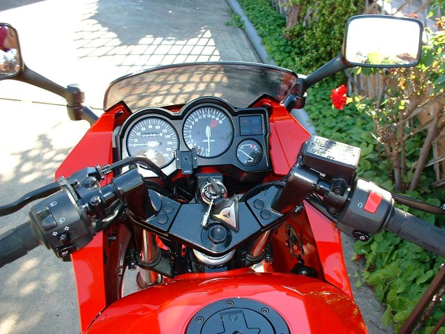

El-cheapo Bike Computer would be your best bet and if you shop around you will find a waterproof one. You can even use it for a speedo if you get one with a four-digit readout (some only read to 100km/h).
The backlight is harder. Some have one but it's activated by a pushbutton. I also found the little buttons hard to manage wearing gloves and attempts to hardwire it failed as they time out after a few seconds to conserve your battery. If you're handy with a soldering iron and don't mind fiddling it may be easier to remove the backlight globes/LEDs and install your own small LEDs permanently wired into the bike power.
I borrowed this (crappy) pic from http:www/ninja250.org:
FWIW I mounted mine on the dash between the tacho and speedo. As the speedos are designed to strap onto a handlebar and your bike (as did my GPX250R) has rudimentary clip-ons I made a mount out of a small slice of thin broomstick painted matt black and epoxyed to the dash. I glued the computer mount to the slice of broomstick:
