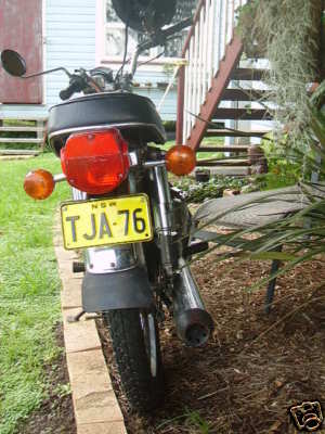

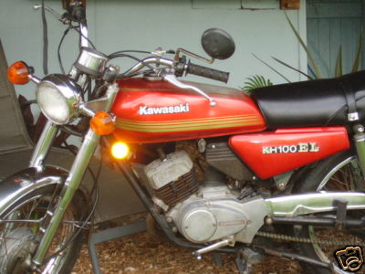

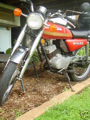

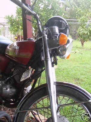

Pictures
Z1000
ZX10R
GSXR 1100 WP
Slow and wobbly
Posts: 1541
Re: 1980 KH100 EL
Post by Slow and wobbly »
Wow!
They grow in your garden too!
Seems that way around here! They just keep popping up! :D
Looks good as a basis of an easy and simple resto job. Some TLC and a focused effort on each component could see it really shine. I really want one like this in original trim that I could use for nipping up the street (legally).
Leave it original and accept it for what it is. Take pride in each little job you do and it will definitely be a rewarding little bike, along with enriching your motorcycle knowledge.
I offer to you anything you need in the way of parts or information, just let me know.
