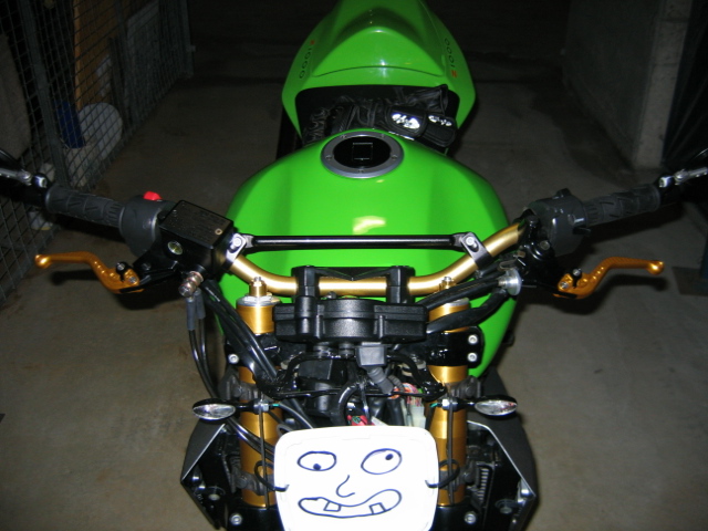

i have renthal street fighter bars on my 04 Z1000 and love them. they are lower and straighter than stock and have a cross brace which i like the look of. remember after market bars are hollow so you will have to buy new end weights (stock ones screw in). get the heavyist ones you can to reduce vibration. you can also fill the bars with something heavy like lead sinkers to reduce vibes even more

best pic i got

Yeah they look good. Exactly wat im looking for.
Did you shorten them or did they come that width?
i have bar end mirrors so need to find bar end to work with them.

i didnt modify them. they are slightly wider than the factory ones. i was like you and wanted them no wider than stock. i used some stainless steel ( for the weight ) universal bar ends from http://ausfr.com.au/index.asp they are great people to deal with and are very friendly and helpfull i have got heaps of stuff from them.
forgot to mention im using CRG lane splitter bar end mirrors and everything fits ( just ).
