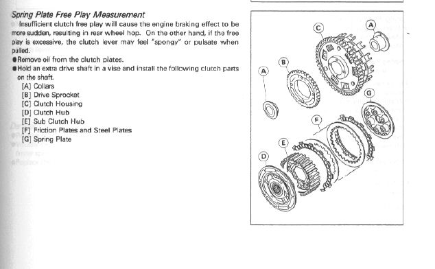

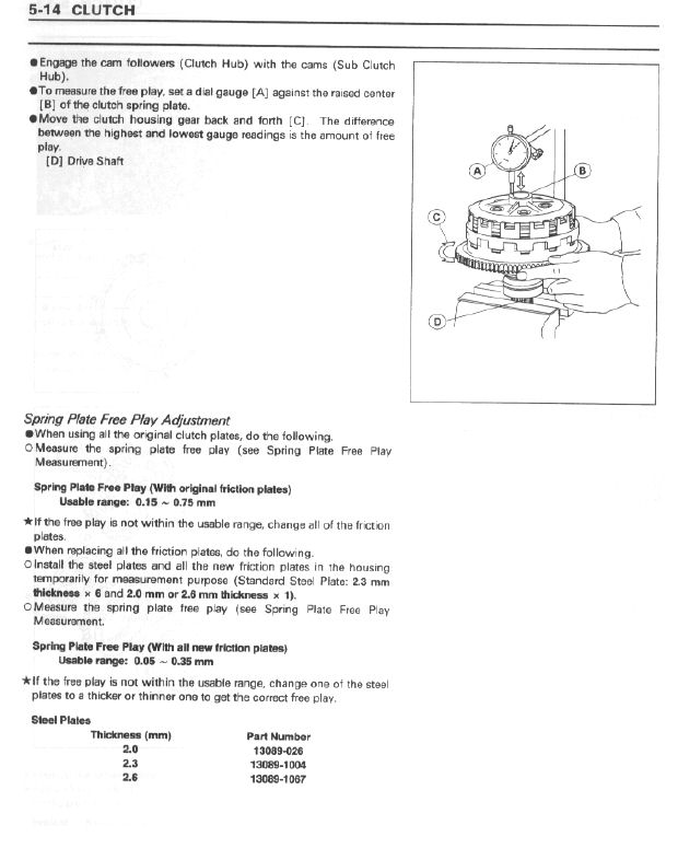

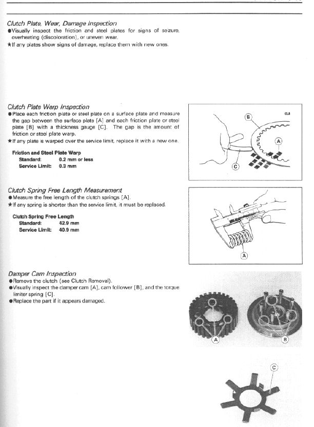

oldmanmike
Posts: 89
Joined: Wed Jan 23, 2008 3:08 pm
Re: new to the ZX9R
Post by oldmanmike »
Washers on to of the springs WILL limit the travel.
On the 125GP bikes we used to get extra clutch "grip" by spreading the spring coils.
That said its not a big task on the b's to take the cover off and pull the clutch apart to measure the fibers & plates.
Vital bits from the manual..
