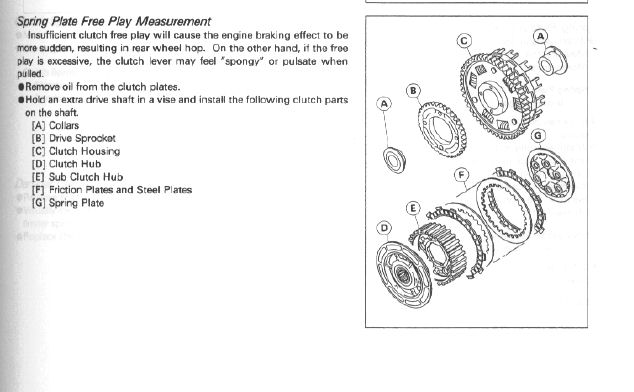

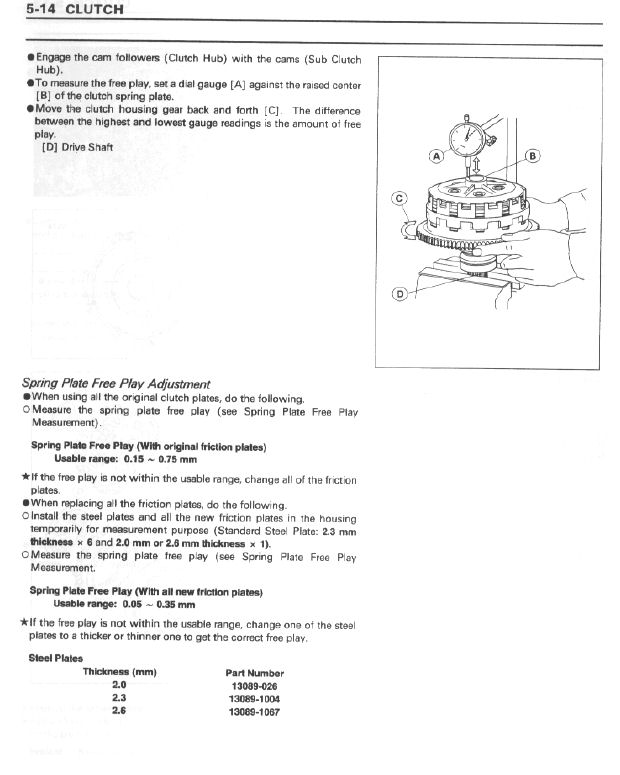

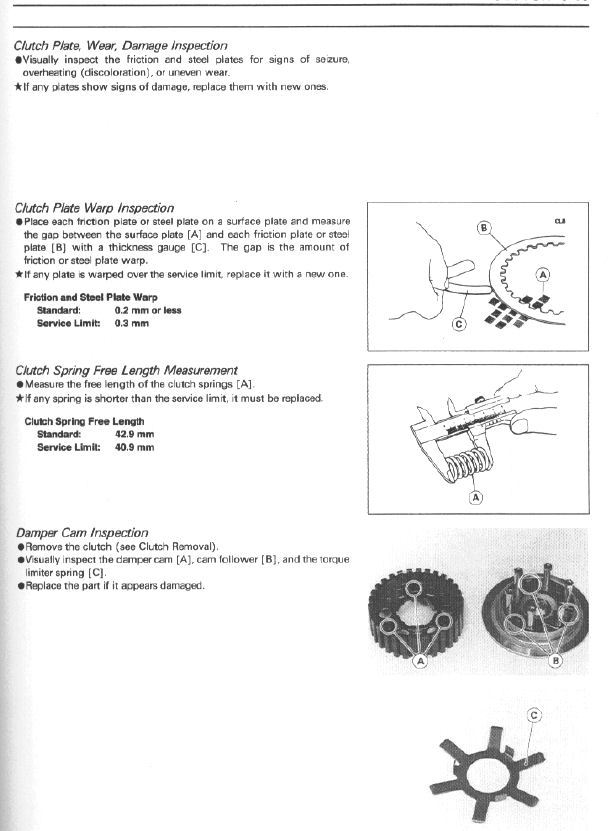

by oldmanmike
Washers on to of the springs
WILL limit the travel.
On the 125GP bikes we used to get extra clutch "grip" by spreading the spring coils.
That said its not a big task on the b's to take the cover off and pull the clutch apart to measure the fibers & plates.
Vital bits from the manual..
- Image1.jpg (40.65 KiB) Viewed 2667 times
