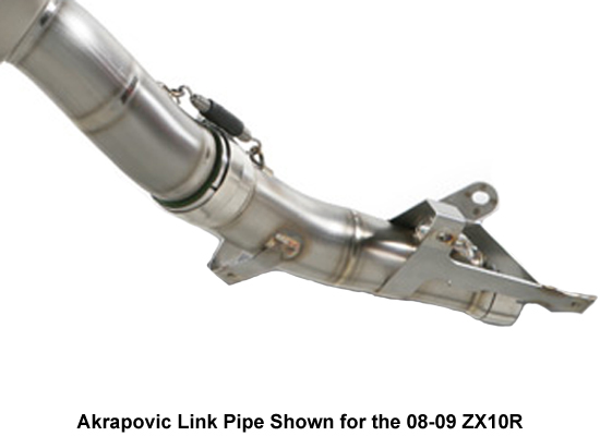

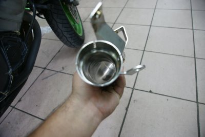

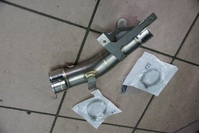

Well the mid pipe for my 08 ZX10 finally arrived (actually just before I headed off to Eastern Creek)
It fitted perfectly, as you would expect Akrapovic parts to fit... They have used the same outlet size, which utilizes the stock graphite gasket which also fits perfectly, and the other end is sized to slip over the main pipe, metal to metal. All this is great, but they did not include any clamps for these fittings..!! this was apparantly a stuff up from the place that shipped them... so they are sending the clamps now.. :roll:
I tried to use the stock clamps packing up the front pipe just to see if it would work, but it leaked really bad.. and even the rear clamp which is supposed to be the correct size just does not clamp properly.. you can tighten it till a vein in your temple bursts and it still not be tight..?? Anyway, through some excellent advice from 'Triway'..(from this forum and great mate as well) I attended a local engineering workshop and got some excellent clamps that really do work...!! Did the proper install using some silicon, and these clamps pull up nice and round and hard.. perfect fit.. squishing the excess silicon out.. they look great, very pro and not one single leak, the system sits firm and solid.. and the sound is awesome... that ugly heavy box really soaks up the exhaust note we all love so much... :D
Anyway, Akrapovic states that just the use of this link pipe will add an extra 2 hp across the entire rev range, with the use of an Akrapovic slip on, or in my case a Leo Vince SBK Race pipe, the total gain is 9.5 hp..!! :shock: This is without any other mods.. Unbelievable (considering we really dont need any more power, but it's great to have it.. and I just love to free the beast of its restrictions). next thing is to get rid of the stock air filter and that will do me for this bike. Macca :kuda:

Mid Pipe (with clamps !!)
ZX10R Akro Link Pipe 2.JPG (19.93 KiB) Viewed 3978 times

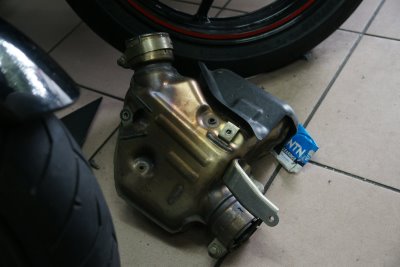

Heavy Fat Collector Box - Now Gone !!
ZX10R Akro Link Pipe 3.JPG (18.59 KiB) Viewed 3975 times
Mid Pipe Pic from Akrapovic
ZX10R pipe 6.jpg (50.67 KiB) Viewed 3977 times

just a question mate.. is there anything actually in that box????
i have read that it has nothing in it, just find it abit odd.

Hi Dano...
Well the box (Pre Chamber as it is actually called) for our Australian bikes is basically another muffler... It is full of steel - perforated inside, yes you can see through it, the pipe is reduced in diameter and the rest of the box just acts as a silencer. It is quite heavy, and combined with the stock muffler weighs something like 8.5kg's.. In fact I am going to put the two together and actually weigh it for those who really want the accurate facts.. cause they are very heavy..!!! It is the same as running two mufflers in a row... just to make it very quiet....!!
I dont know why they made this box so big and heavy really...?? :? but the bottom plate bolts onto it and that finishes off the look of the bike side profile.. The akrapovic pipe allows for the bottom plate so the bike still looks good side profile without having a gaping hole there like on some other systems.
The USA Pre Chamber actually has a secondary catalytic convertor built into it... (I have a cut away picture of this)... as their emmisions laws are much more than ours... So they have to run through 2 x cats.. which produces much heat and soaks up much HP...!! This is why the yanks call it a 'Cat Box'
Getting rid of this box opens up the pipe so it is actually the same diameter all the way through with no resistance to the flow right through to the muffler.. Just like most performance exhaust systems. The total gains verses the weight drop are definitely worth it....
