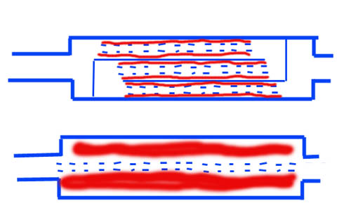

I've opened two road bike silencers over the years. The first was a stock Yamaha can from an FZx750, the second a Staintune for my CBR600.
The Yamaha can consisted of 3 perforated pipes linking between an entry chamber, a mid chamber and the exit. Each pipe was surrounded by baffling material. This gave the silencer, effectivly three times it's lenght in silencing ability.
The Staintune was simply a straight through perforated pipe surrounded by baffling. It also came with a plug that effectivly reduced the size of the exit, and pushed some of the exhaust gas back through the baffling.
I am sure that there are a variety of differing designs, with various size perforated pipes, chambers and baffling thickness. Each design will effect gas pressure very differently, and thus effect the engine performance. I would also expect each silencer is tuned to that particular engine dynamic.
- exhaust.jpg (42.83 KiB) Viewed 4157 times

The Pipeline that came on my FJ1100 was spectacularly (painfully) loud, and was of the straight-through perforated pipe type. Not quite on a par with the "If your ears ain't bleeding, the bike's not running" Harley philosophy, but it did make the windows rattle. I'm more after the rumble/roar of the 4-1 Yoshi I put on the GPz1100 (which was sourced from a ZZR1100, which has a different top-end, and which started me thinking about this whole pipe difference thing in the first place)
It's hard to imagine that a manufacturer like Yoshimura would have different can internals for a ZX9, ZX10, CBR1000, GSX-R1000 etc. It'd be interesting to look at part numbers for slip-ons...
...even more interesting to see if a muffler for a VTR1000 was different internally to one from a CBR1000; wondering if the engine configuration makes a huge difference; Inline 4, triple, V-twin? Might look up some wrecked cans from my mate at the wreckers and have a look inside.

4-1, 4-2, 4-1-2 etc all have different back pressures and effect power production - often where in the rev range the power is produced. This will be done in conjunction with head design and valve timing.
Also, each can has to be designed for the particular bike, as the feed pipes and mounting points are different. It may well be that most race silencers are of similar design, aimed for top end power, where tourer pipes would all be similar to produce better mid range power. Headers are designed to give the same gas flow lenght from the cylinder to the tailpipe for each cylinder. Real trick headers have bends to enhance flow rates and back pressures.
