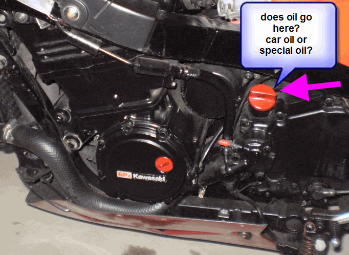

i just got a 1986 kawasaki gpz1000, when i picked it up, started like a dream, couple days later turns over but not starting. no manual with it or anything.
so what sort of oil should i put in it and where does it go: see pic.

Yes that looks like it's where the oil goes.
What kind is a matter for much debate
For the older beasts you might want a mineral or synth blend variety rather than full synthetic - I found Penrite to be good in the older engines.
But - I suggest waiting for the gurus to speak up regarding the best things for the old gpz1000

That's correct, that's the oil filler cap. Use a motorcycle specific oil which is designed for use in a wet clutch motor.primamateria wrote:i just got a 1986 kawasaki gpz1000, when i picked it up, started like a dream, couple days later turns over but not starting. no manual with it or anything.

+1Strika wrote:That's correct, that's the oil filler cap. Use a motorcycle specific oil which is designed for use in a wet clutch motor.primamateria wrote:i just got a 1986 kawasaki gpz1000, when i picked it up, started like a dream, couple days later turns over but not starting. no manual with it or anything.
if you put car oil in it will cause problems such as clutch slippind and stuff

Re: this may be silly question but...
do not overfill either thinking that is a good thing to do....only fill to the top marking in the window or on dipstick !

the window hoffy is talking about is in your pic almost directly below..look for half circle in pic possibly full glass circle on your bike.....not familiar with gpzsssssssssss

so the oil is for both the engine and the gearbox too? I was wondering, even though obviously bikes are manual transmissions (except scooters and some new retro looking honda) whether or not it needed any transmission fluid.

just undid red cap (screwable sump valve thingy, not oil filler cap) )which let out a stack of oil, refilled it and now I can see the oil level in the window. the previous oil was that dark, unable to tell if indicator window was working all right!
