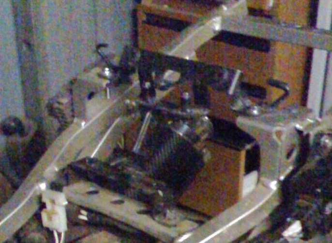

With the road gear you put the ducktail on, attach the seat and then put the pillion seat or cover on the ducktail. As the race ducktail is all one piece my weary brain can't work out another way to attach the seat with the ducktail in place.

Yeah it comes right down behind the seat and the original bracket comes from inside the ducktail. Only way I can see it to put some sort of screw up from the bottom but not sure.

On mine yo get to the bolt from under the back of the ducktail but my sub frame has been completly gutted. On others I have seen that they cut a small hole in the tail to access the bolt through the top.

Just screw straight throught the top of the seat :shock: You end up with two small holes, but the foam covers the screw heads, it's only a trackie....

here you go mate,,,,,, step 1\before putting the tail on ,bolt the seat down/pic 1,,,,,,,,step 2\now slide the tail on /pic 2,,,,,,,,,step 3\line the screw holes up and tighten/pic 3&4,,,,,,and there you have it ;) :D

Mine is a bit different to Paul's. Ignore the lifting blocks I fitted to it to raise the seat but you can see the front and back brackets that hold the seat down. I get it on and off with a Phillips head screwdriver poked through the top cover at the back of the seat. I will have to get more pics tomorrow to show you what I mean.

Thanks everyone. Nelso's the same as mine (F series). Just been out taking a photo. The original rear bracket mounts high in the ducktail so looks like the high tech fix is to screw through the top of the seat as smithy5 suggested too.
Takes me to try to find the hard way to do it...hehehe :kuda:
The black bracket just behind the fuse carrier is what the seat rests on and the holding bracket slots into the back of the seat at then attaches to the higher cross bracket high up in the front of the ducktail.
