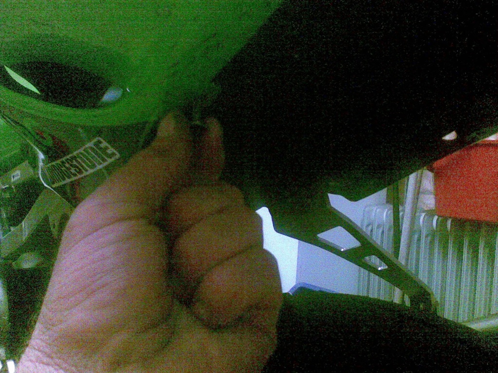

- shinnynoggon
- Posts: 1400
- Bike: ZX12R
- Location: Sydney

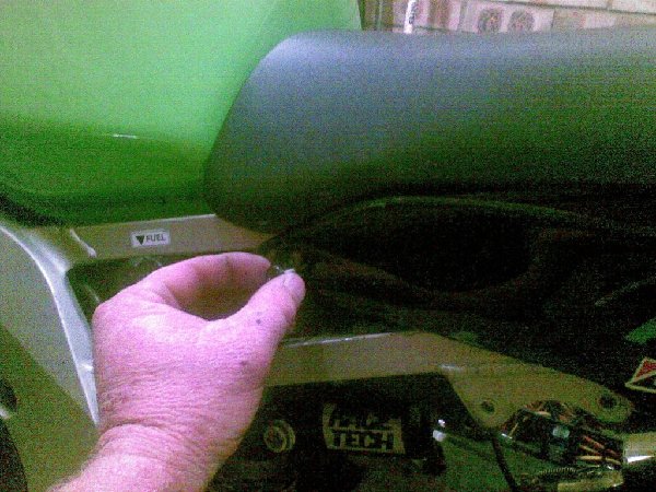

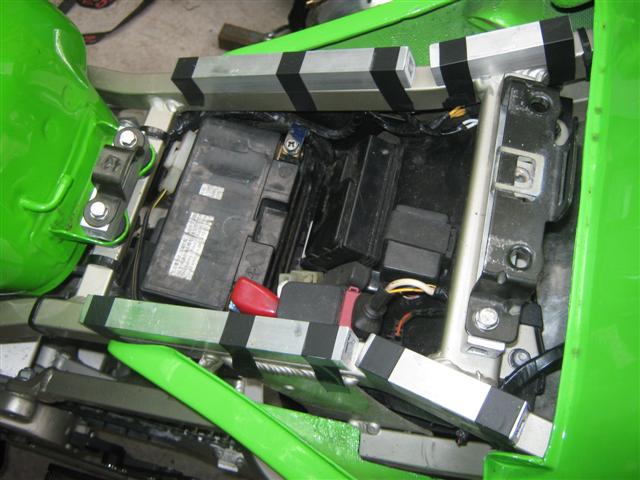

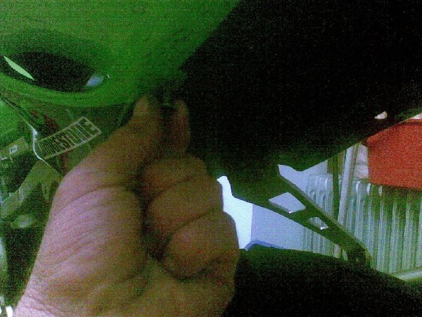

Re: Attaching seat on ZX9 tracky
here you go mate,,,,,, step 1\before putting the tail on ,bolt the seat down/pic 1,,,,,,,,step 2\now slide the tail on /pic 2,,,,,,,,,step 3\line the screw holes up and tighten/pic 3&4,,,,,,and there you have it

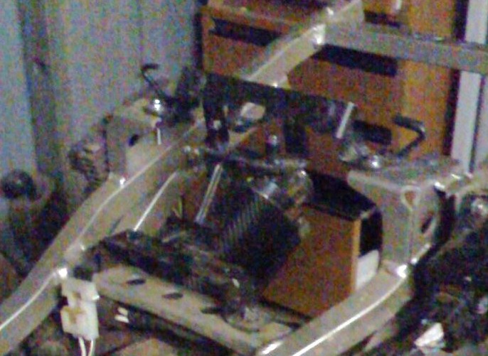

Mine is a bit different to Paul's. Ignore the lifting blocks I fitted to it to raise the seat but you can see the front and back brackets that hold the seat down. I get it on and off with a Phillips head screwdriver poked through the top cover at the back of the seat. I will have to get more pics tomorrow to show you what I mean.

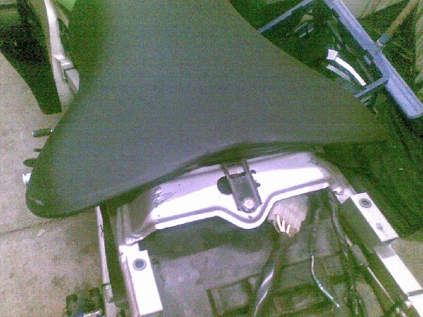

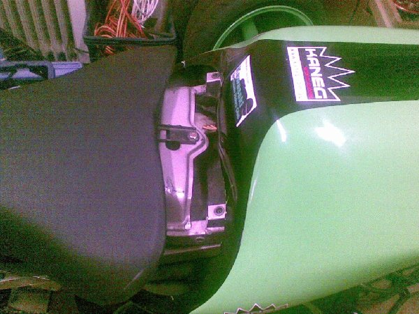

Thanks everyone. Nelso's the same as mine (F series). Just been out taking a photo. The original rear bracket mounts high in the ducktail so looks like the high tech fix is to screw through the top of the seat as smithy5 suggested too.
Takes me to try to find the hard way to do it...hehehe
The black bracket just behind the fuse carrier is what the seat rests on and the holding bracket slots into the back of the seat at then attaches to the higher cross bracket high up in the front of the ducktail.
